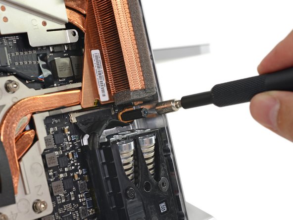

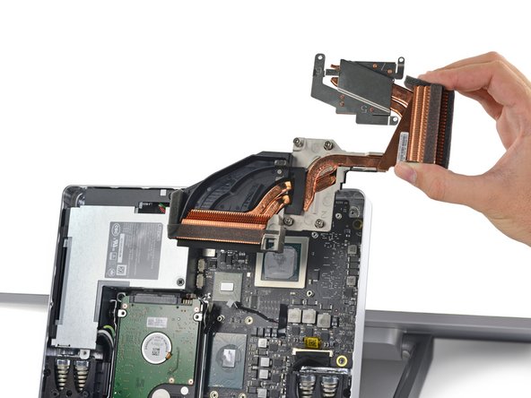

    • A screw retaining the power supply is under the hard drive so both the hard drive and the heat sink assembly must be removed
    • Remove four spring loaded torx screw labeled 1 to 4
    • Remove four torx screw labeled 5 to 7
    • Remove 5mm hex mounting post
    • Use a spudger to remove the heatsink assembly from the motherboard

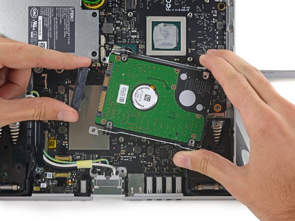

    • Remove three torx screws holding the hard drive brackets
    • Remove the hard drive and disconnect the SATA/SATA power cable

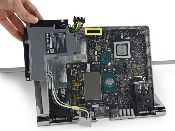

    • Remove a Phillips screw still retaining the power supply
    • Remove a torx screw retaining the power supply cable
    • Unplug the power supply from the motherboard
    • Lift the power supply up and away from the base unit
