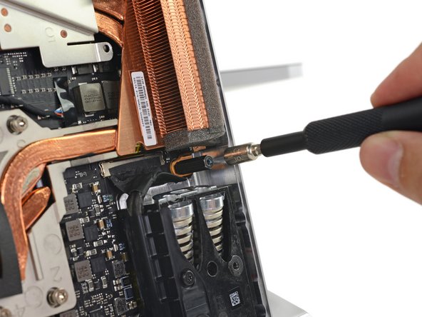

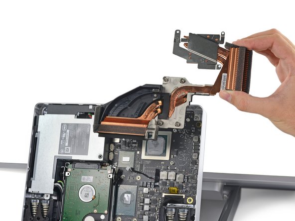

  4. Surface Studio Motherboard Replacement: crwdns2935265:04crwdnd2935265:01crwdnd2935265:03crwdne2935265:0 Surface Studio Motherboard Replacement: crwdns2935265:04crwdnd2935265:02crwdnd2935265:03crwdne2935265:0 Surface Studio Motherboard Replacement: crwdns2935265:04crwdnd2935265:03crwdnd2935265:03crwdne2935265:0
    • Remove four spring loaded torx screw labeled 1 to 4
    • Remove four torx screw labeled 5 to 7
    • Remove 5mm hex mounting post
    • Use a spudger to remove the heatsink assembly from the motherboard

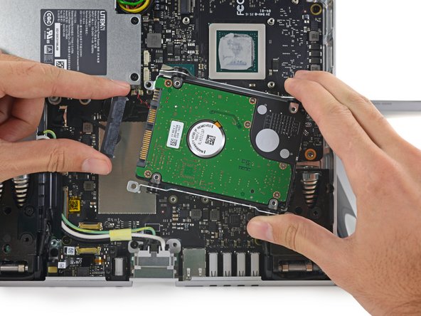

  5. Surface Studio Motherboard Replacement: crwdns2935265:05crwdnd2935265:01crwdnd2935265:02crwdne2935265:0 Surface Studio Motherboard Replacement: crwdns2935265:05crwdnd2935265:02crwdnd2935265:02crwdne2935265:0
    • Remove three torx screws holding the hard drive brackets
    • Remove the hard drive and disconnect the SATA/SATA power cable

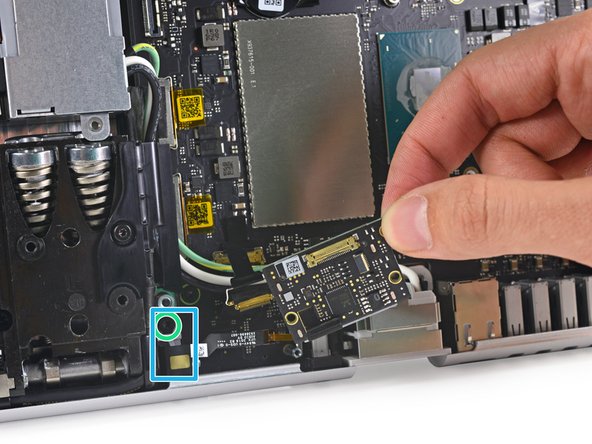

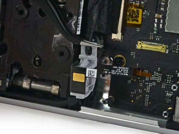

  6. Surface Studio Motherboard Replacement: crwdns2935265:06crwdnd2935265:01crwdnd2935265:03crwdne2935265:0 Surface Studio Motherboard Replacement: crwdns2935265:06crwdnd2935265:02crwdnd2935265:03crwdne2935265:0 Surface Studio Motherboard Replacement: crwdns2935265:06crwdnd2935265:03crwdnd2935265:03crwdne2935265:0
    • Lift the black plastic flap attached to the data cable retainer and rotate it away from motherboard.
    • Pull the data cable out of its socket.
    • The data cable socket is very fragile. Do not lift the connector upward as you disconnect it, as the socket may break off the motherboard. Pull the cable parallel to the face of the motherboard.
    • Disconnect the data cable connecting the headphone jack to the SD card slot modular board
    • Remove three torx screws holding the SD card slot modular board
    • Remove the SD card slot modular board
    • Remove a torx screw holding the headphone jack
    • Remove the headphone jack

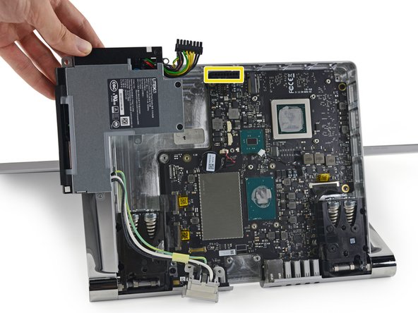

  7. Surface Studio Motherboard Replacement: crwdns2935265:07crwdnd2935265:01crwdnd2935265:02crwdne2935265:0 Surface Studio Motherboard Replacement: crwdns2935265:07crwdnd2935265:02crwdnd2935265:02crwdne2935265:0
    • Although removing the power supply is not necessary, it makes accessing the connectors easier
    • Remove a Phillips screw still retaining the power supply
    • Remove a torx screw retaining the power supply cable
    • Unplug the power supply from the motherboard
    • Lift the power supply up and away from the base unit

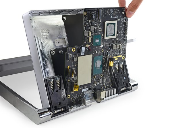

  8. Surface Studio Motherboard Replacement: crwdns2935265:08crwdnd2935265:01crwdnd2935265:02crwdne2935265:0 Surface Studio Motherboard Replacement: crwdns2935265:08crwdnd2935265:02crwdnd2935265:02crwdne2935265:0
    • Remove three torx screws holding the motherboard
    • Lift the motherboard up and away from the base unit.
