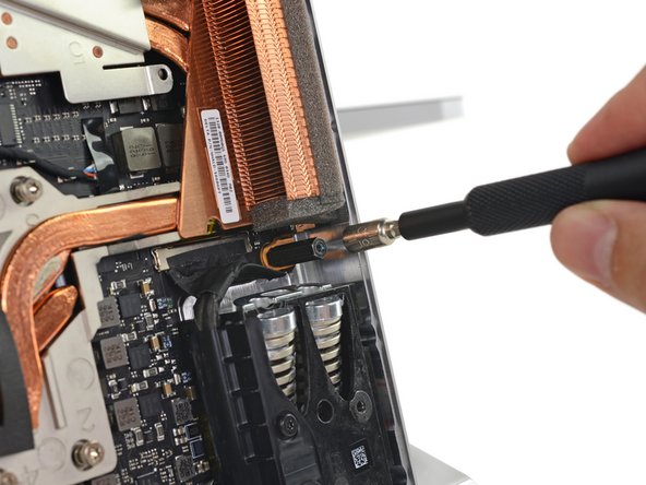

    • With the midframe removed, it is also possible to replace the M.2 SSD during this step
    • The hard drive is underneath the heatsink so the heatsink must be removed
    • Fully loosen (they don't come out) the four spring loaded torx screws labeled 1 to 4;
    • Remove three torx screw labeled 5 to 7
    • Remove 5mm hex mounting post
    • Use a spudger to remove the heatsink assembly from the motherboard

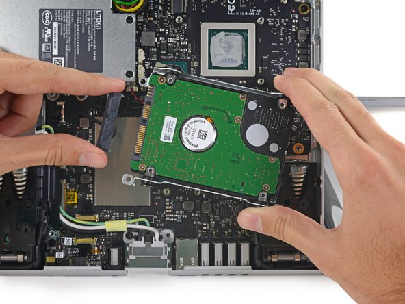

    • Remove three torx screws holding the hard drive brackets
    • Remove the hard drive and disconnect the SATA/SATA power cable
    • Remove four torx screws holding the hard drive brackets to the hard drive
    • On reassembly, be sure to clean the CPU and GPU and heat sink and reapply thermal compound to the CPU and GPU

Thank you for this step by step guide to replace the "Hard Drive" Here are a few measures that I took before drive replacement:
1) have to turn off drive encryption
2) I cloned the drive to the new SSD drive (I used Samsung 850 PRO 1TB) using Acronis True Image
3) Replaced the drive followed your instructions.
4) Turned ON the Surface Studio and success! no issues and better performance.
