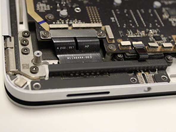

  7. Surface Laptop Studio Headphone Jack Replacement, Headphone Jack: crwdns2935265:07crwdnd2935265:01crwdnd2935265:03crwdne2935265:0 Surface Laptop Studio Headphone Jack Replacement, Headphone Jack: crwdns2935265:07crwdnd2935265:02crwdnd2935265:03crwdne2935265:0 Surface Laptop Studio Headphone Jack Replacement, Headphone Jack: crwdns2935265:07crwdnd2935265:03crwdnd2935265:03crwdne2935265:0
    • Remove the left I/O bracket by unscrewing the the 3 M1109237 Screws with your T3 Torx screwdriver.

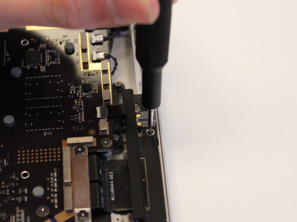

  8. Surface Laptop Studio Headphone Jack Replacement: crwdns2935265:08crwdnd2935265:01crwdnd2935265:01crwdne2935265:0
    • Remove the two M1168360 screws on the headphone jack with your T3 Torx screwdriver.
