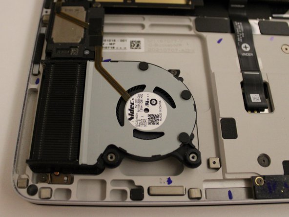

  7. Surface Laptop Studio Fan Replacement, Fan: crwdns2935265:07crwdnd2935265:01crwdnd2935265:02crwdne2935265:0 Surface Laptop Studio Fan Replacement, Fan: crwdns2935265:07crwdnd2935265:02crwdnd2935265:02crwdne2935265:0
    • Remove the screws securing both of the fans with a T3 Torx screwdriver.
  8. Surface Laptop Studio Fan Replacement: crwdns2935265:08crwdnd2935265:01crwdnd2935265:01crwdne2935265:0
    • Flip up the ZIF locking flap on each socket.
    • Disconnect the ribbon cables attached to each fan.
  9. Surface Laptop Studio Fan Replacement: crwdns2935265:09crwdnd2935265:01crwdnd2935265:02crwdne2935265:0 Surface Laptop Studio Fan Replacement: crwdns2935265:09crwdnd2935265:02crwdnd2935265:02crwdne2935265:0
    • Lift the fans up and out.
