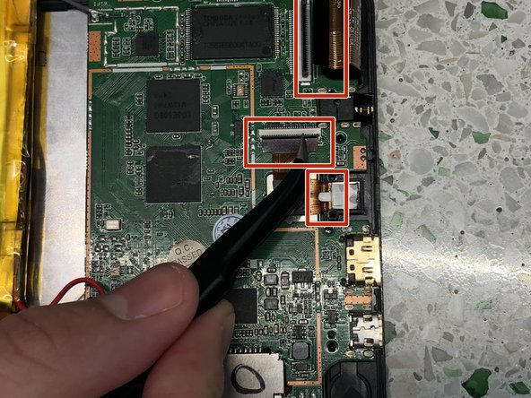

    • Use a PH000 screwdriver to unscrew all four motherboard screws.
  3. Supersonic SC-777BT Motherboard Replacement: crwdns2935265:03crwdnd2935265:01crwdnd2935265:03crwdne2935265:0 Supersonic SC-777BT Motherboard Replacement: crwdns2935265:03crwdnd2935265:02crwdnd2935265:03crwdne2935265:0 Supersonic SC-777BT Motherboard Replacement: crwdns2935265:03crwdnd2935265:03crwdnd2935265:03crwdne2935265:0

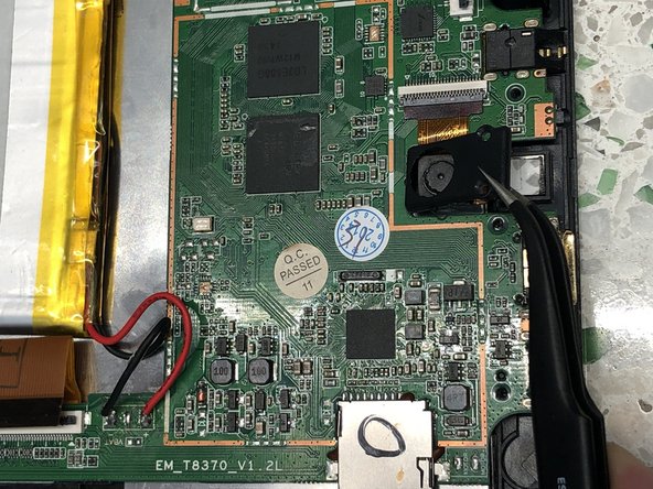

    • Unscrew the holder of the camera and gently remove using tweezers.
    • Remove the sensors using tweezers.

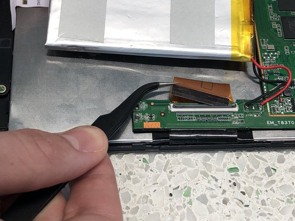

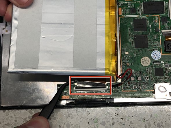

  4. Supersonic SC-777BT Motherboard Replacement: crwdns2935265:04crwdnd2935265:01crwdnd2935265:03crwdne2935265:0 Supersonic SC-777BT Motherboard Replacement: crwdns2935265:04crwdnd2935265:02crwdnd2935265:03crwdne2935265:0 Supersonic SC-777BT Motherboard Replacement: crwdns2935265:04crwdnd2935265:03crwdnd2935265:03crwdne2935265:0
    • Detach the battery.
    • Battery is attached with adhesive; no tools needed to remove.
    • Using tweezers, lift and release the ribbon cable that was covered by the battery.

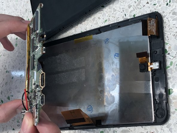

  5. Supersonic SC-777BT Motherboard Replacement: crwdns2935265:05crwdnd2935265:01crwdnd2935265:02crwdne2935265:0 Supersonic SC-777BT Motherboard Replacement: crwdns2935265:05crwdnd2935265:02crwdnd2935265:02crwdne2935265:0
    • Carefully remove the motherboard with your hands.
