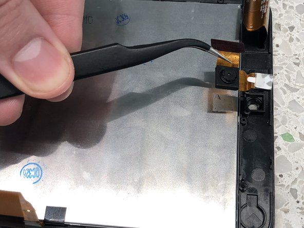

    • Remove the back cover using the plastic opening tool.
    • Open the cover like a book so you do not disconnect the yellow plastic holding the cover to the motherboard.
  2. Supersonic SC-777BT Camera Replacement: crwdns2935265:02crwdnd2935265:01crwdnd2935265:03crwdne2935265:0 Supersonic SC-777BT Camera Replacement: crwdns2935265:02crwdnd2935265:02crwdnd2935265:03crwdne2935265:0 Supersonic SC-777BT Camera Replacement: crwdns2935265:02crwdnd2935265:03crwdnd2935265:03crwdne2935265:0
    • Remove the two screws using the screwdriver.
    • Use the tweezers to pull the camera out of place.
    • Be gentle while pulling it out so you do not pull any extra components out.
  3. Supersonic SC-777BT Camera Replacement: crwdns2935265:03crwdnd2935265:01crwdnd2935265:01crwdne2935265:0
    • Disconnect the yellow ribbon cable from the connector.
  4. Supersonic SC-777BT Camera Replacement: crwdns2935265:04crwdnd2935265:01crwdnd2935265:02crwdne2935265:0 Supersonic SC-777BT Camera Replacement: crwdns2935265:04crwdnd2935265:02crwdnd2935265:02crwdne2935265:0
    • Remove camera.
    • It should just peel off like a sticker.
