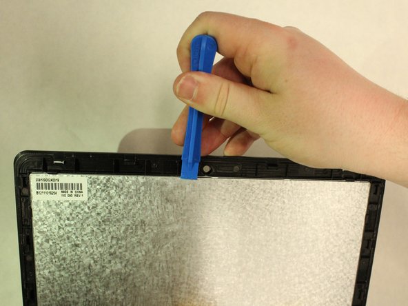

    2. Supersonic Matrix SC-91MID Screen Replacement: crwdns2935265:02crwdnd2935265:01crwdnd2935265:03crwdne2935265:0 Supersonic Matrix SC-91MID Screen Replacement: crwdns2935265:02crwdnd2935265:02crwdnd2935265:03crwdne2935265:0 Supersonic Matrix SC-91MID Screen Replacement: crwdns2935265:02crwdnd2935265:03crwdnd2935265:03crwdne2935265:0
      • Place the plastic opening tool between the metal screen plate and the black front casing.
      • There are small clips where the plastic opening tool can be placed to help pry the screen from the casing.

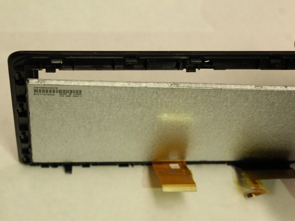

    3. Supersonic Matrix SC-91MID Screen Replacement: crwdns2935265:03crwdnd2935265:01crwdnd2935265:03crwdne2935265:0 Supersonic Matrix SC-91MID Screen Replacement: crwdns2935265:03crwdnd2935265:02crwdnd2935265:03crwdne2935265:0 Supersonic Matrix SC-91MID Screen Replacement: crwdns2935265:03crwdnd2935265:03crwdnd2935265:03crwdne2935265:0
      • Continue to slide the opening tool along the length of the casing until there is a clear separation between the screen and the cover (as shown in the third image).
    4. Supersonic Matrix SC-91MID Screen Replacement: crwdns2935265:04crwdnd2935265:01crwdnd2935265:01crwdne2935265:0
      • Once there is a clearing, carefully remove the screen from the black cover. You now have separated the screen from the tablet device and and are now ready to replace screen.
