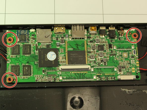

    • Use the plastic opening tool to separate the screen from the back cover.
  2. Supersonic Matrix SC-91MID Motherboard Replacement: crwdns2935265:02crwdnd2935265:01crwdnd2935265:01crwdne2935265:0
    • Use the tweezers to lift the tab shown in the picture, and remove the orange ribbon from it gently. Repeat for all three ribbons on the device.
  3. Supersonic Matrix SC-91MID Motherboard Replacement: crwdns2935265:03crwdnd2935265:01crwdnd2935265:02crwdne2935265:0 Supersonic Matrix SC-91MID Motherboard Replacement: crwdns2935265:03crwdnd2935265:02crwdnd2935265:02crwdne2935265:0
    • Use the Phillips 1.5 mm screwdriver (Phillips #000) to unscrew the green motherboard from the body at the three points
    • Remove the washers (red)
  4. Supersonic Matrix SC-91MID Motherboard Replacement: crwdns2935265:04crwdnd2935265:01crwdnd2935265:02crwdne2935265:0 Supersonic Matrix SC-91MID Motherboard Replacement: crwdns2935265:04crwdnd2935265:02crwdnd2935265:02crwdne2935265:0
    • Use a hot soldering tool to desolder the wires connecting the motherboard to the speaker. Desolder the wires connecting the motherboard to the battery.
    • Red: Speakers
    • Orange: Battery
    • Yellow: LED
    • Check if your replacement motherboard comes with an LED. You may have to desolder the LED from your old motherboard and solder it to your replacement.
