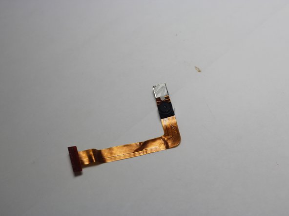

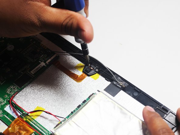

  6. SuperSonic Matrix Mid SC-999 Motherboard Replacement, Rear Facing Camera: crwdns2935265:06crwdnd2935265:01crwdnd2935265:02crwdne2935265:0 SuperSonic Matrix Mid SC-999 Motherboard Replacement, Rear Facing Camera: crwdns2935265:06crwdnd2935265:02crwdnd2935265:02crwdne2935265:0
    • Remove the two Phillips #00 screws attaching the housing of the camera to the device.
  7. SuperSonic Matrix Mid SC-999 Motherboard Replacement: crwdns2935265:07crwdnd2935265:01crwdnd2935265:01crwdne2935265:0
    • With the screws removed you should easily be able to remove the camera unit.
  8. SuperSonic Matrix Mid SC-999 Motherboard Replacement: crwdns2935265:08crwdnd2935265:01crwdnd2935265:02crwdne2935265:0 SuperSonic Matrix Mid SC-999 Motherboard Replacement: crwdns2935265:08crwdnd2935265:02crwdnd2935265:02crwdne2935265:0
    • Follow the camera unit back to the motherboard.
    • Use the spudger tool to remove the camera.
