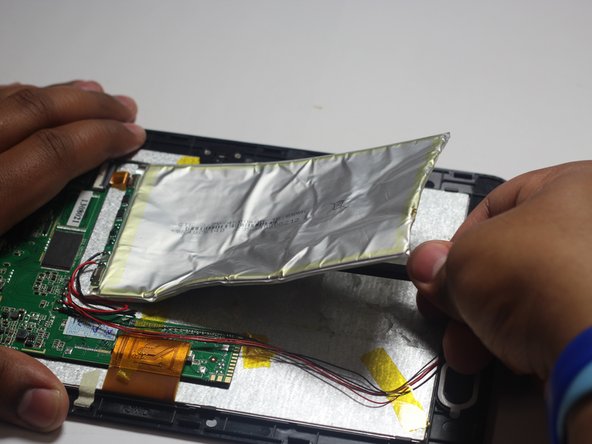

  4. SuperSonic Matrix Mid SC-999 LCD Replacement, Battery: crwdns2935265:04crwdnd2935265:01crwdnd2935265:03crwdne2935265:0 SuperSonic Matrix Mid SC-999 LCD Replacement, Battery: crwdns2935265:04crwdnd2935265:02crwdnd2935265:03crwdne2935265:0 SuperSonic Matrix Mid SC-999 LCD Replacement, Battery: crwdns2935265:04crwdnd2935265:03crwdnd2935265:03crwdne2935265:0

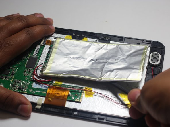

    • Remove the Battery
    • The battery is secured to the back panel with tape and glue.
    • Peel back the tape around the battery and discard it.
    • Tear through the adhesive holding the battery by using the spudger tool.

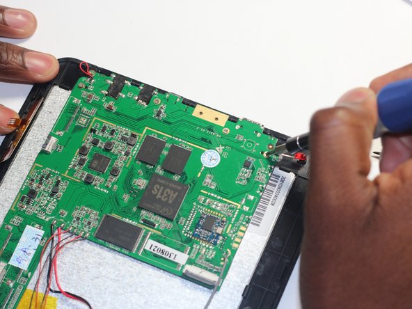

  5. SuperSonic Matrix Mid SC-999 LCD Replacement: crwdns2935265:05crwdnd2935265:01crwdnd2935265:03crwdne2935265:0 SuperSonic Matrix Mid SC-999 LCD Replacement: crwdns2935265:05crwdnd2935265:02crwdnd2935265:03crwdne2935265:0 SuperSonic Matrix Mid SC-999 LCD Replacement: crwdns2935265:05crwdnd2935265:03crwdnd2935265:03crwdne2935265:0

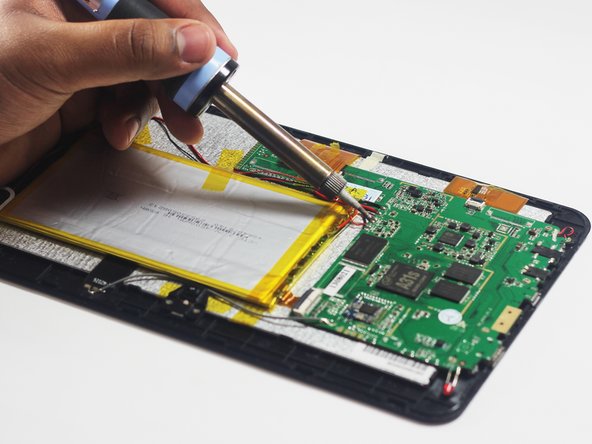

    • Desolder the 2 Battery Wires
    • The Battery has two wires connected to the motherboard (one black and one red).
    • If you're unfamiliar with soldering or desoldering check out this guide.
    • Be sure to wear protective eye wear. The soldering iron will become extremely hot and a potential danger, so make sure you are aware of your surroundings.

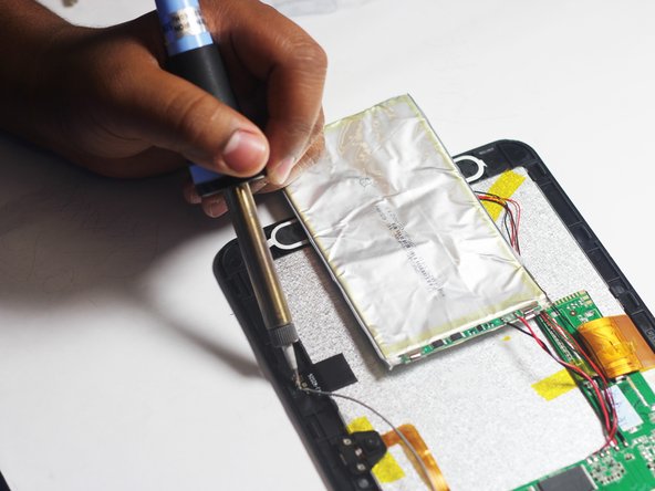

  6. SuperSonic Matrix Mid SC-999 LCD Replacement, Speaker: crwdns2935265:06crwdnd2935265:01crwdnd2935265:01crwdne2935265:0
    • Remove the Speakers
    • Use the tweezers to remove the speakers from their compartments.
  7. SuperSonic Matrix Mid SC-999 LCD Replacement: crwdns2935265:07crwdnd2935265:01crwdnd2935265:02crwdne2935265:0 SuperSonic Matrix Mid SC-999 LCD Replacement: crwdns2935265:07crwdnd2935265:02crwdnd2935265:02crwdne2935265:0
    • Desolder the 4 Speaker Wires
    • These wires connect the speakers to the motherboard. They are the thinnest wires.
    • Be sure to wear protective eye wear. Also, keep in mind that the soldering iron will become extremely hot.

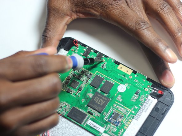

  8. SuperSonic Matrix Mid SC-999 LCD Replacement, Microphone: crwdns2935265:08crwdnd2935265:01crwdnd2935265:01crwdne2935265:0
    • Remove the microphone from its compartment.
    • The microphone is located toward the bottom left corner of the device (assuming the speakers are located on the right side of you).
  9. SuperSonic Matrix Mid SC-999 LCD Replacement: crwdns2935265:09crwdnd2935265:01crwdnd2935265:02crwdne2935265:0 SuperSonic Matrix Mid SC-999 LCD Replacement: crwdns2935265:09crwdnd2935265:02crwdnd2935265:02crwdne2935265:0
    • Use the soldering iron to remove the wires connected to the microphone.
    • If you're unfamiliar with soldering or desoldering, check out this guide.

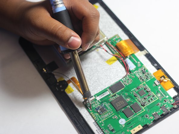

  10. SuperSonic Matrix Mid SC-999 LCD Replacement, FM Antenna: crwdns2935265:010crwdnd2935265:01crwdnd2935265:02crwdne2935265:0 SuperSonic Matrix Mid SC-999 LCD Replacement, FM Antenna: crwdns2935265:010crwdnd2935265:02crwdnd2935265:02crwdne2935265:0
    • Use a soldering iron to desolder the region circled in red.
    • Be sure to wear protective eye wear. The soldering iron will become extremely hot and a potential danger, so be aware of your surroundings.
  11. SuperSonic Matrix Mid SC-999 LCD Replacement: crwdns2935265:011crwdnd2935265:01crwdnd2935265:02crwdne2935265:0 SuperSonic Matrix Mid SC-999 LCD Replacement: crwdns2935265:011crwdnd2935265:02crwdnd2935265:02crwdne2935265:0
    • Desolder the FM antenna from the motherboard.

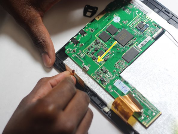

  12. SuperSonic Matrix Mid SC-999 LCD Replacement, Motherboard: crwdns2935265:012crwdnd2935265:01crwdnd2935265:02crwdne2935265:0 SuperSonic Matrix Mid SC-999 LCD Replacement, Motherboard: crwdns2935265:012crwdnd2935265:02crwdnd2935265:02crwdne2935265:0

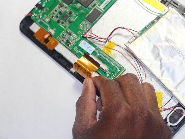

    • Remove the large ribbon cable from the socket that attaches it to the motherboard.
    • Pull down on the dark grey sliders located on both sides of the ribbon cable to release it.
  13. SuperSonic Matrix Mid SC-999 LCD Replacement: crwdns2935265:013crwdnd2935265:01crwdnd2935265:02crwdne2935265:0 SuperSonic Matrix Mid SC-999 LCD Replacement: crwdns2935265:013crwdnd2935265:02crwdnd2935265:02crwdne2935265:0
    • Remove the small ribbon cable from the socket that attaches it to the motherboard.
    • Flip the dark grey latch to release the ribbon cable from the motherboard.
  14. SuperSonic Matrix Mid SC-999 LCD Replacement: crwdns2935265:014crwdnd2935265:01crwdnd2935265:03crwdne2935265:0 SuperSonic Matrix Mid SC-999 LCD Replacement: crwdns2935265:014crwdnd2935265:02crwdnd2935265:03crwdne2935265:0 SuperSonic Matrix Mid SC-999 LCD Replacement: crwdns2935265:014crwdnd2935265:03crwdnd2935265:03crwdne2935265:0
