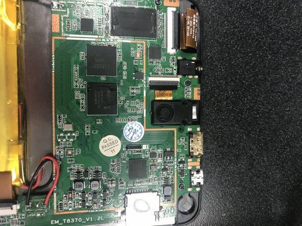

  2. SuperSonic Matrix Mid SC-999 Camera Replacement, Finding the Camera: crwdns2935265:02crwdnd2935265:01crwdnd2935265:02crwdne2935265:0 SuperSonic Matrix Mid SC-999 Camera Replacement, Finding the Camera: crwdns2935265:02crwdnd2935265:02crwdnd2935265:02crwdne2935265:0
    • Locate the camera.
    • Unscrew the two screws.

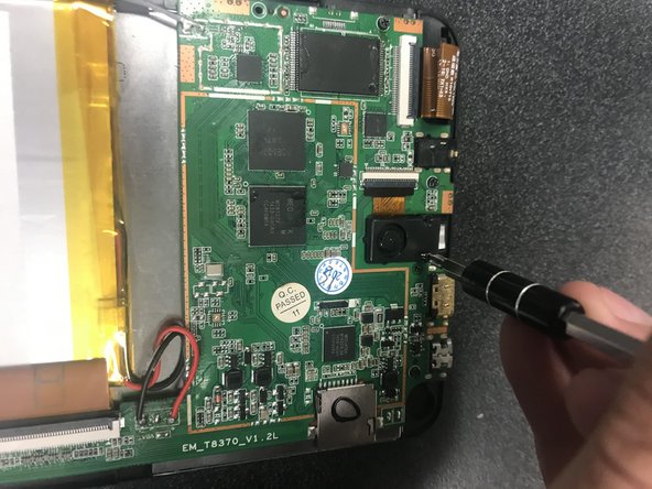

  3. SuperSonic Matrix Mid SC-999 Camera Replacement, Unscrewing the Cover: crwdns2935265:03crwdnd2935265:01crwdnd2935265:03crwdne2935265:0 SuperSonic Matrix Mid SC-999 Camera Replacement, Unscrewing the Cover: crwdns2935265:03crwdnd2935265:02crwdnd2935265:03crwdne2935265:0 SuperSonic Matrix Mid SC-999 Camera Replacement, Unscrewing the Cover: crwdns2935265:03crwdnd2935265:03crwdnd2935265:03crwdne2935265:0
    • Use the J0 Phillps screw driver to unscrew the the two small screws on either side of the black peice.

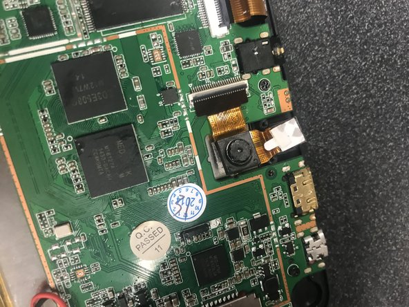

  4. SuperSonic Matrix Mid SC-999 Camera Replacement, Opening Up to the Camera: crwdns2935265:04crwdnd2935265:01crwdnd2935265:02crwdne2935265:0 SuperSonic Matrix Mid SC-999 Camera Replacement, Opening Up to the Camera: crwdns2935265:04crwdnd2935265:02crwdnd2935265:02crwdne2935265:0
    • Pull the black camera cover off and locate the camera with two gold bands running off upwards and to the right.

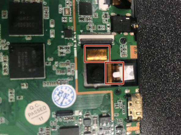

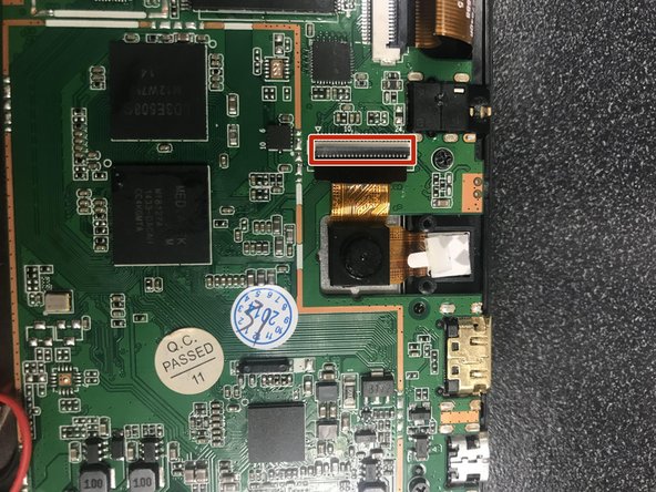

  5. SuperSonic Matrix Mid SC-999 Camera Replacement, Finding Where the Camera and Motherboard Meet: crwdns2935265:05crwdnd2935265:01crwdnd2935265:01crwdne2935265:0
    • Follow the gold band the runs up towards the white and grey box connected to the green plate.

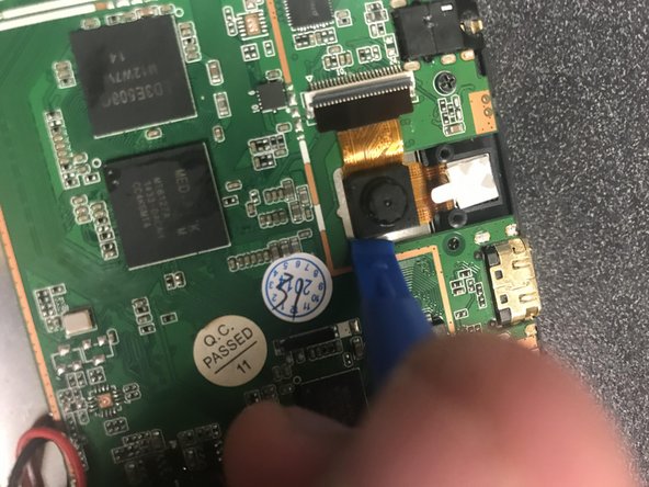

  6. SuperSonic Matrix Mid SC-999 Camera Replacement, Unhocking the Camera from Motherboard: crwdns2935265:06crwdnd2935265:01crwdnd2935265:02crwdne2935265:0 SuperSonic Matrix Mid SC-999 Camera Replacement, Unhocking the Camera from Motherboard: crwdns2935265:06crwdnd2935265:02crwdnd2935265:02crwdne2935265:0
    • Use the wedge from step one to lift the grey box up.
    • The grey piece should open up towards you.

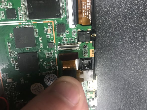

  7. SuperSonic Matrix Mid SC-999 Camera Replacement, Finding the Camera Pt. 2: crwdns2935265:07crwdnd2935265:01crwdnd2935265:01crwdne2935265:0
    • Now turn your attention back the camera.
  8. SuperSonic Matrix Mid SC-999 Camera Replacement, Finding the Front Camera: crwdns2935265:08crwdnd2935265:01crwdnd2935265:01crwdne2935265:0
    • Next, Follow the second gold band to right to the white paper, or the front camra.
  9. SuperSonic Matrix Mid SC-999 Camera Replacement, Unhocking the Front Camera from device: crwdns2935265:09crwdnd2935265:01crwdnd2935265:01crwdne2935265:0
    • Now, carefully remove the front camera with the same wedge from step one, six, and eight.
  10. SuperSonic Matrix Mid SC-999 Camera Replacement, Unhocking the Back Camera from Device: crwdns2935265:010crwdnd2935265:01crwdnd2935265:03crwdne2935265:0 SuperSonic Matrix Mid SC-999 Camera Replacement, Unhocking the Back Camera from Device: crwdns2935265:010crwdnd2935265:02crwdnd2935265:03crwdne2935265:0 SuperSonic Matrix Mid SC-999 Camera Replacement, Unhocking the Back Camera from Device: crwdns2935265:010crwdnd2935265:03crwdnd2935265:03crwdne2935265:0
    • Use the same wedge used in step one and step six to go under the camera and carefully pry away from the sivler plating.

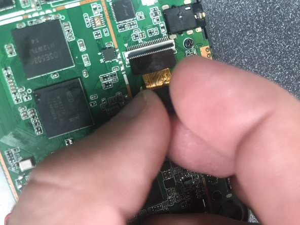

  11. SuperSonic Matrix Mid SC-999 Camera Replacement, Taking the Camra System Off the Device.: crwdns2935265:011crwdnd2935265:01crwdnd2935265:03crwdne2935265:0 SuperSonic Matrix Mid SC-999 Camera Replacement, Taking the Camra System Off the Device.: crwdns2935265:011crwdnd2935265:02crwdnd2935265:03crwdne2935265:0 SuperSonic Matrix Mid SC-999 Camera Replacement, Taking the Camra System Off the Device.: crwdns2935265:011crwdnd2935265:03crwdnd2935265:03crwdne2935265:0
    • When the camera becomes loose, gental pull up and out to the right to silde the gold band out of the white and grey box.
