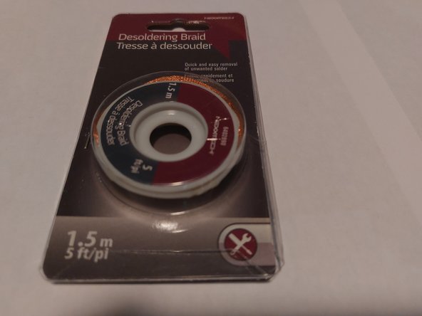

    • Use the soldering iron and the de-soldering braid to remove any excess soldering adhesive.
    • Excess solder needs to be removed so that the new battery can be mounted properly.
