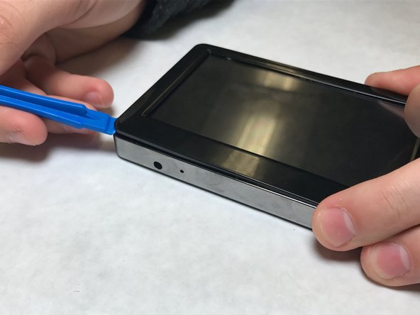

    • Carefully pry up one of the top corners of the screen with a plastic spudger (prying tool). Slide the tool along the edges to release it from the housing.
    • The screen may make some cracking noises as you pry it from the casing. This is expected.
    • The screen is still connected to the motherboard. Use force with caution.

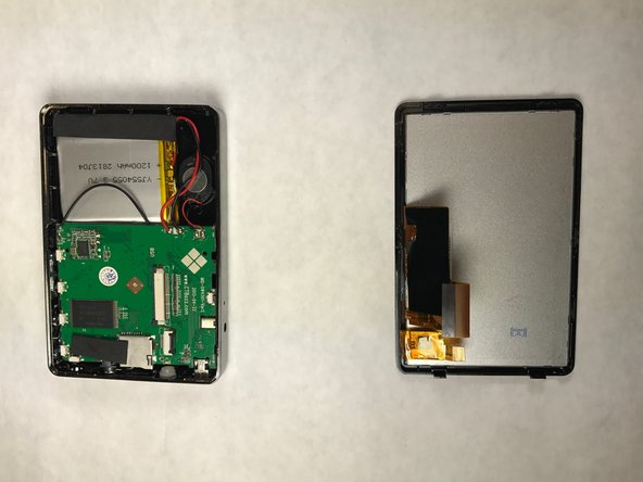

  4. Sungale CyberUs Screen Replacement: crwdns2935265:04crwdnd2935265:01crwdnd2935265:01crwdne2935265:0
    • Gently turn screen over, to the side, to reveal the ZIF connector attached to the motherboard.
  5. Sungale CyberUs Screen Replacement: crwdns2935265:05crwdnd2935265:01crwdnd2935265:01crwdne2935265:0
    • Gently using tweezers, flip the black clip up. Pull the ZIF connector out.
    • You screen is still not completely detached from the device.
  6. Sungale CyberUs Screen Replacement: crwdns2935265:06crwdnd2935265:01crwdnd2935265:02crwdne2935265:0 Sungale CyberUs Screen Replacement: crwdns2935265:06crwdnd2935265:02crwdnd2935265:02crwdne2935265:0
    • Using the prying tool, slide the black clip out. Pull the ZIF connector out and to the left, the screen is now detached from the motherboard.
