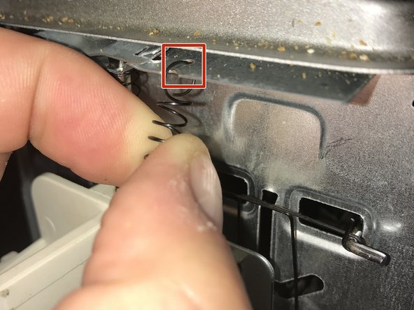

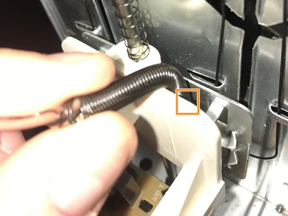

  7. Sunbeam 2-Slice Extra Wide Slot Toaster Latch Spring Replacement: crwdns2935265:07crwdnd2935265:01crwdnd2935265:03crwdne2935265:0 Sunbeam 2-Slice Extra Wide Slot Toaster Latch Spring Replacement: crwdns2935265:07crwdnd2935265:02crwdnd2935265:03crwdne2935265:0 Sunbeam 2-Slice Extra Wide Slot Toaster Latch Spring Replacement: crwdns2935265:07crwdnd2935265:03crwdnd2935265:03crwdne2935265:0
    • Be sure to remember where the spring is attached to prevent frustration putting the new spring on.
    • Locate the spring shown in the first picture.
    • After locating the spring, remove the top part of the spring first. The top part of the spring can be seen in the second picture.
    • After locating the bottom part of the spring, this can be seen from the third picture, remove the bottom part of the spring.
