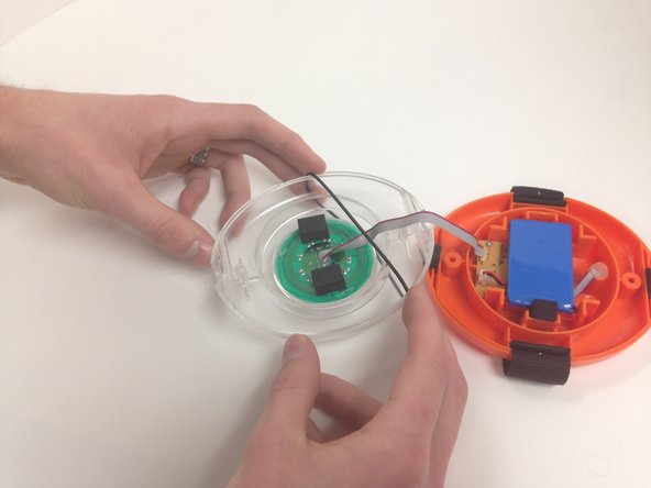

    • Place the lamp LED side down on a clean workspace.
    • Remove the screws holding the casing together using a Phillips #1 Screwdriver.
  2. Sun King Solo Solar Lantern Device Seals Replacement, Separate the Device: crwdns2935265:02crwdnd2935265:01crwdnd2935265:01crwdne2935265:0
    • Gently pull the two halves of the lamp apart.
  3. Sun King Solo Solar Lantern Device Seals Replacement, O-ring Replacement: crwdns2935265:03crwdnd2935265:01crwdnd2935265:02crwdne2935265:0 Sun King Solo Solar Lantern Device Seals Replacement, O-ring Replacement: crwdns2935265:03crwdnd2935265:02crwdnd2935265:02crwdne2935265:0
    • On the clear upper half, remove the black O-ring
    • Place the new O-ring, making sure it is smooth all the way around
  4. Sun King Solo Solar Lantern Device Seals Replacement, Stand Holder Replacements: crwdns2935265:04crwdnd2935265:01crwdnd2935265:01crwdne2935265:0
    • Remove the rubber stand holders.
    • Place the new stand holders, making sure the wings of the holder are in the second opening
