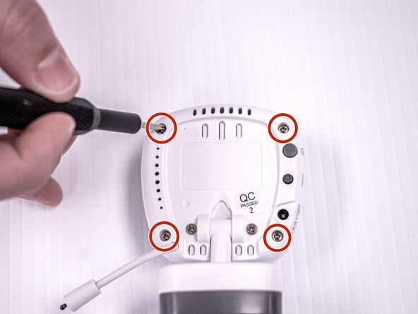

    • Remove the plastic wall mount attached to the base of the stand.
    • Remove the four 9 mm screws on the back four corners of the camera using a Phillips #00 screwdriver.
    • If needed, gently bend the antenna of the camera towards you to access the screw in the bottom left corner.

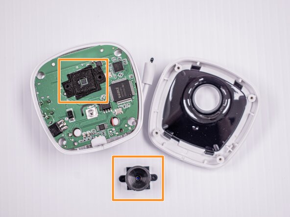

    • Gently remove the front casing.
    • The motherboard will go with the front casing, so don't pull too hard or else the wires connected to the speaker might break.
    • The back of the motherboard should already be facing up.

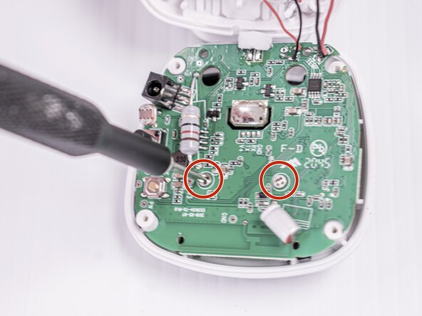

    • Remove the two 5 mm screws near the upper center on the back of the motherboard using a Phillips #00 screwdriver.
    • The old camera lens will fall off after the screws are removed.
    • Replace the new lens.
