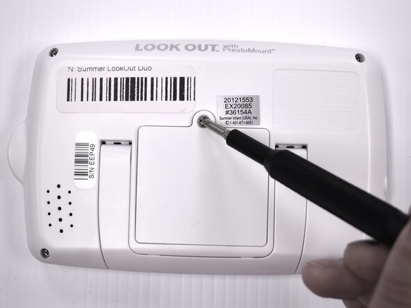

    • Flip the device over so the back is facing up.
    • Remove the 9 mm screw using a Phillips #1 screwdriver.
    • Lift the battery panel away from the device.

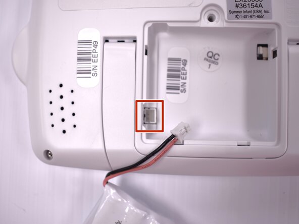

    • Flip the handheld monitor over and let the battery fall out into your hand.

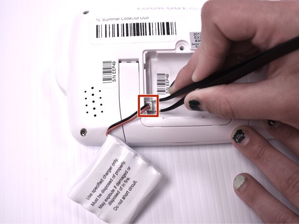

    • Using angled tweezers, gently remove the plastic wire coupling from the side of the open battery compartment.
    • If the coupling struggles to release, with a loose but firm grip, slightly wiggle the plastic wire coupling back and forth until it releases.
    • Remove the battery from the device.
