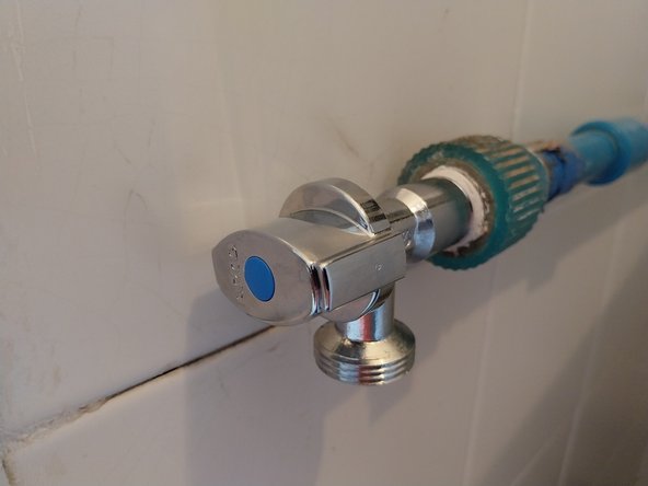

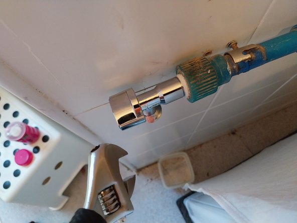

  3. Substitution of faucet strainer, or washroom.: crwdns2935265:03crwdnd2935265:01crwdnd2935265:02crwdne2935265:0 Substitution of faucet strainer, or washroom.: crwdns2935265:03crwdnd2935265:02crwdnd2935265:02crwdne2935265:0
    • For disassembly, we will use a plumber's pliers or "Adjustable" parrot beak pliers to hold the pipe so that it is not damaged. We hold the faucet with a fixed wrench or a roller wrench, placing the wrench at the height of the stem where we will have the greatest support surface.
    • We are turning counterclockwise.

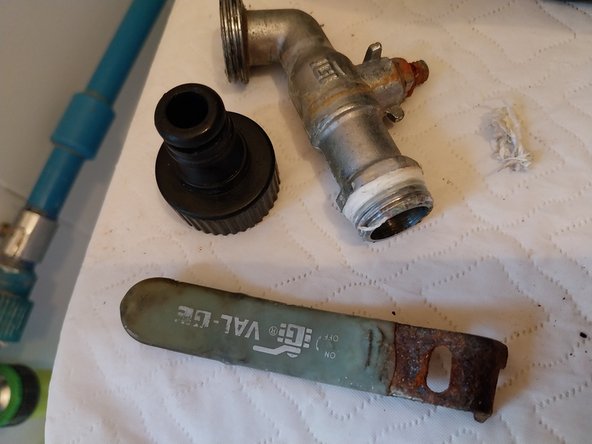

  4. Substitution of faucet strainer, or washroom.: crwdns2935265:04crwdnd2935265:01crwdnd2935265:02crwdne2935265:0 Substitution of faucet strainer, or washroom.: crwdns2935265:04crwdnd2935265:02crwdnd2935265:02crwdne2935265:0
    • Image of the faucet already dismantled and the lamentable state it was already in.

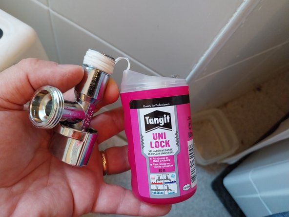

    • 1º We present the tap on the pipe, to check that it is the same size 1/2" in this case and that it will not collide with the wall.
    • 2º On the thread of the faucet so that it does not lose water, we can apply different elements, depending on what each of you has or can purchase, such as tow (already somewhat out of use), Teflon tape (you have to apply many turns so that acquires a suitable body or surface and has the problem that if we overturn.
    • We cannot reposition it, we must disassemble it again, re-tape it with Teflon and start again.

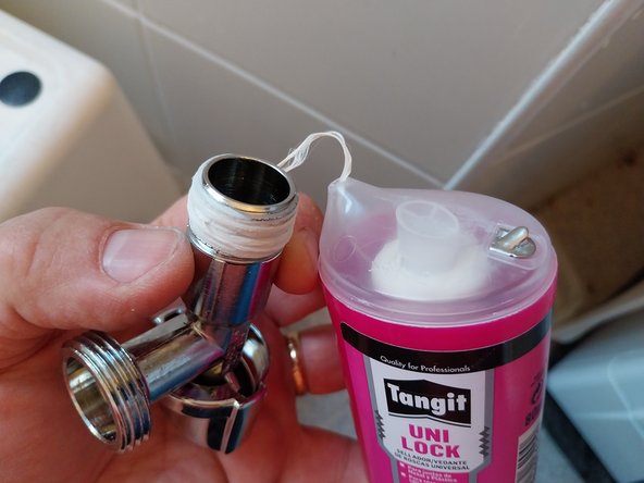

    • Since I discovered it, I almost always only use Teflon thread with an added component that is in the form of grease. The truth is that I was reluctant to use it, but it works very well, it seals perfectly, I have never used Teflon again.
    • We will make about 2 to 2.5 passes of thread along the entire thread, cutting it with the cutter that already includes the cap.

    • Holding the pipe with our hand, we will begin to thread by hand in a clockwise direction, as much as possible. When we can no longer thread by hand, we will use pliers and a roller wrench as in step 3.
    • We will leave the tap centered, if we have turned it too far, the Teflon thread allows us to do a slight touch-up in reverse.

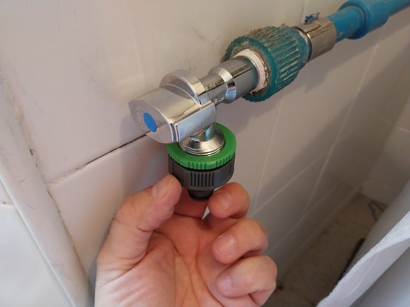

    • In this case I place the adapter to be able to plug in a hose, since I have replaced the tap and the cost of the adapter is low, I also replace it, as these adapters age, the toroidal rubber gasket at the end wears out and they leak water, It is the one that appears orange in step 4.
