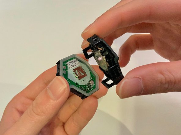

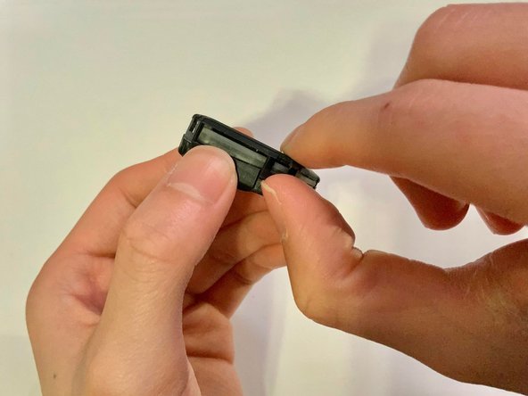

  4. Subaru Legacy 2009 Key Fob Battery Replacement: crwdns2935265:04crwdnd2935265:01crwdnd2935265:03crwdne2935265:0 Subaru Legacy 2009 Key Fob Battery Replacement: crwdns2935265:04crwdnd2935265:02crwdnd2935265:03crwdne2935265:0 Subaru Legacy 2009 Key Fob Battery Replacement: crwdns2935265:04crwdnd2935265:03crwdnd2935265:03crwdne2935265:0
    • Use a spudger or your fingernails to pry open the four clips securing the keyless fob.
    • Ensure that you pinch the fob on the side, not the top, during the opening to avoid accidentally re-securing the clips.

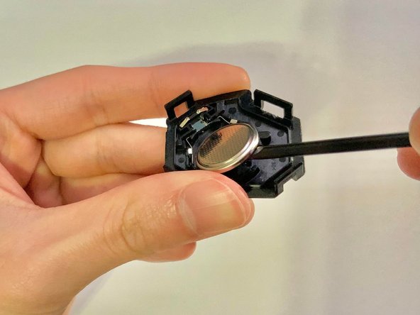

  5. Subaru Legacy 2009 Key Fob Battery Replacement: crwdns2935265:05crwdnd2935265:01crwdnd2935265:03crwdne2935265:0 Subaru Legacy 2009 Key Fob Battery Replacement: crwdns2935265:05crwdnd2935265:02crwdnd2935265:03crwdne2935265:0 Subaru Legacy 2009 Key Fob Battery Replacement: crwdns2935265:05crwdnd2935265:03crwdnd2935265:03crwdne2935265:0

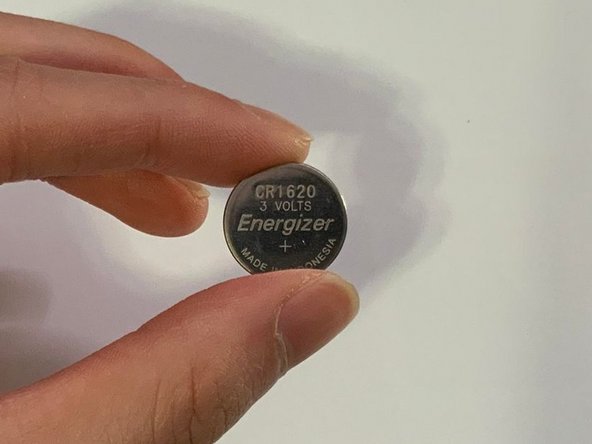

    • Gently slide a spudger beneath the battery to lift it from the case.
    • Replace it with a new CR1620 3V lithium coin battery.
    • Reassemble the key fob.
