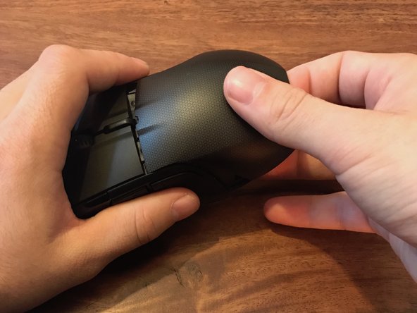

  5. Steelseries Rival 700 Gaming Mouse Disassembly, Top cover removal: crwdns2935265:05crwdnd2935265:01crwdnd2935265:03crwdne2935265:0 Steelseries Rival 700 Gaming Mouse Disassembly, Top cover removal: crwdns2935265:05crwdnd2935265:02crwdnd2935265:03crwdne2935265:0 Steelseries Rival 700 Gaming Mouse Disassembly, Top cover removal: crwdns2935265:05crwdnd2935265:03crwdnd2935265:03crwdne2935265:0
    • Use both your index and thumb to gently pry the top cover out from the mouse.
    • This part is a thin plastic one which needs a certain amount of strength to be removed. Be careful not to break it.
