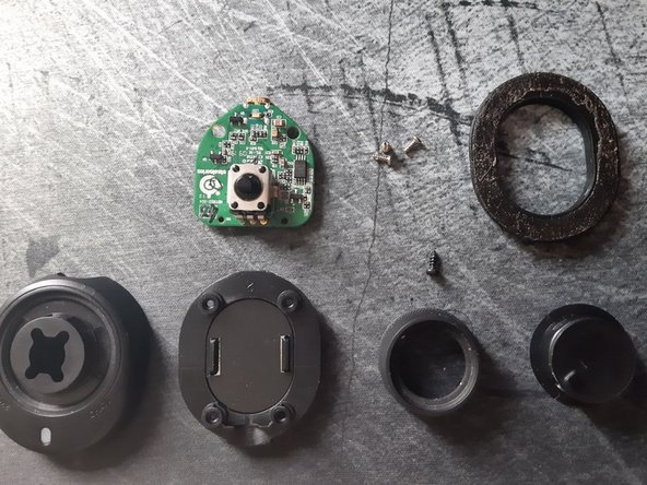

    • To begin, unplug anything chatmix is connected to - headset, and the PC. Flip the chatmix around to the back and remove the glued rubberized oval foot (Top right part on the image)
    • Once the oval foot is removed, You will find four small hex screws. Remove these with a screwdriver. Be careful as they are very easy to strip.
  2. Steelseries Arctis 3/5 Chatmix Dial Knob Cord fix, Further disassembly.: crwdns2935265:02crwdnd2935265:01crwdnd2935265:02crwdne2935265:0 Steelseries Arctis 3/5 Chatmix Dial Knob Cord fix, Further disassembly.: crwdns2935265:02crwdnd2935265:02crwdnd2935265:02crwdne2935265:0
    • Remove the rubberized grooved cover of the knob. The easiest way is to stick something pointy, like a screwdriver, into the top part and pry the rubber part off the knob.
    • Once the rubber is removed, You will be left with the plastic part for the knob. You'll find an opening with a black hex screw inside. Unscrew it, and the PCB should come loose.
  3. Steelseries Arctis 3/5 Chatmix Dial Knob Cord fix, Finding the solder joints.: crwdns2935265:03crwdnd2935265:01crwdnd2935265:01crwdne2935265:0
    • Once you have finished taking it apart, you should have 4 base screws, 1 knob screw, top and bottom housing, knob and the rubber cover as well as the oval foot.
    • Take the PCB and flip it around, so the knob encoder is facing the other direction. The PCB won't sit flat. You may find a black cover over the solder joints near the base, on the opposite end of the PCB from where the headphones connect.
    • Manually remove the black sticky substance over the solder joints. I don't know if heating helps, having gently scraped it off using a pocket knife and my fingers, but a screwdriver would do. Be careful while scraping it off, to not damage any other parts on the PCB.

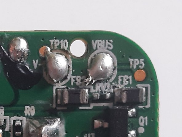

  4. Steelseries Arctis 3/5 Chatmix Dial Knob Cord fix, Resoldering the cable.: crwdns2935265:04crwdnd2935265:01crwdnd2935265:03crwdne2935265:0 Steelseries Arctis 3/5 Chatmix Dial Knob Cord fix, Resoldering the cable.: crwdns2935265:04crwdnd2935265:02crwdnd2935265:03crwdne2935265:0 Steelseries Arctis 3/5 Chatmix Dial Knob Cord fix, Resoldering the cable.: crwdns2935265:04crwdnd2935265:03crwdnd2935265:03crwdne2935265:0
    • Now that you've uncovered the solder joints on the back, you're ready to begin the soldering process. Plug in your soldering iron and let it heat up.
    • To resolder the cable back into the chatmix I recommend using already existing solder joints.
    • Inside your USB cable that connects to the chatmix, You will have 5 internal cables. It consists of standard USB 4 pinout: - Green (D+), White (D-), Red (+5V), Black (Ground)and an additional thicker black cable that wraps around the other four.
    • Looking at the PCB Photos. On the photo of the left side You will find 3 solder joints. Starting from the left You will find: Shell - solder in the extra thick black cable, D- - for the thin white cable, D+ - for the thin green cable.
    • Now look at the right side of the PCB. You will find, going from the right, 2 solder joints: VBUS - for the Red (+5V) cable and V- (for Ground)
    • Begin soldering the cables to their designated joints. Try to keep the USB cable going outwards from the PCB to later be able to easily reassemble the ChatMix.
