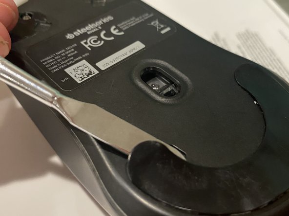

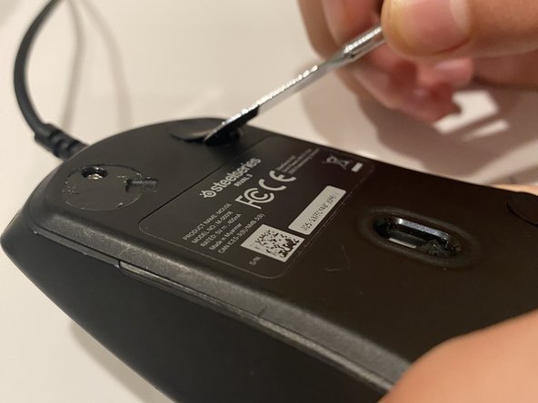

    • Use a metal spudger to carefully loosen the adhesive underneath the mouse skates.
    • The metal spudger might slip, and hurt your hand. Be careful not to push too hard, and instead do a side-to-side motion.
Make sure to peel off the adhesive backing on your new mouse skates before applying them.
