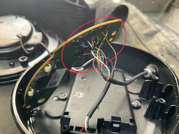

  5. SteelSeries Arctis Pro Wireless Ear Cup Replacement, Left Cables Unsoldering: crwdns2935265:05crwdnd2935265:01crwdnd2935265:02crwdne2935265:0 SteelSeries Arctis Pro Wireless Ear Cup Replacement, Left Cables Unsoldering: crwdns2935265:05crwdnd2935265:02crwdnd2935265:02crwdne2935265:0
    • Gently remove the black glue with a plastic spludger.
    • Then unsolder the cables circled
    • You can also unsolder the 2 cables that connect the speakers to the board but it’s not necessary for the repair.

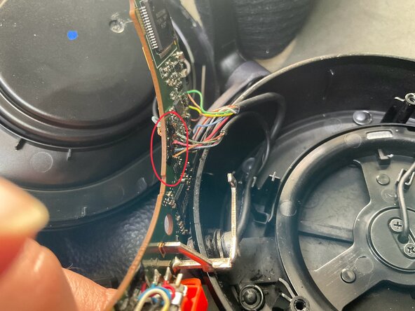

  6. SteelSeries Arctis Pro Wireless Ear Cup Replacement, Right Cables Unsoldering: crwdns2935265:06crwdnd2935265:01crwdnd2935265:02crwdne2935265:0 SteelSeries Arctis Pro Wireless Ear Cup Replacement, Right Cables Unsoldering: crwdns2935265:06crwdnd2935265:02crwdnd2935265:02crwdne2935265:0

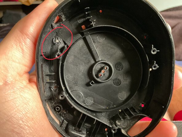

  12. SteelSeries Arctis Pro Wireless Ear Cup Replacement, Power/BT Control Removal: crwdns2935265:012crwdnd2935265:01crwdnd2935265:01crwdne2935265:0
    • On the Battery side at the bottom you’ll have to remove 2 small black plastic levers and a transparent small piece
    • Remove the glue circled in the picture (I don’t have a picture of the glue itself but it will be where it’s circled)
    • Remove the 2 small black pieces and the transparent one.

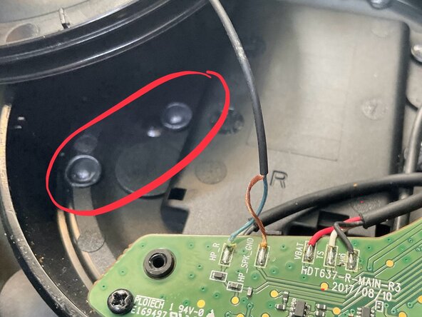

  13. SteelSeries Arctis Pro Wireless Ear Cup Replacement, Magnet Removal: crwdns2935265:013crwdnd2935265:01crwdnd2935265:01crwdne2935265:0
    • Remove the magnets circled with a something thin and sharp.
    • Reinstall everything in order except for the outer/inner panels and the battery.
    • When you make it back to Step 2 and complete it proceed to Step 15
