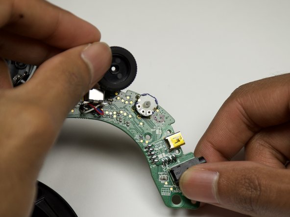

  6. SteelSeries Arctis Pro Plus GameDAC Volume Control Wheel Replacement, Headset Volume Control Wheel: crwdns2935265:06crwdnd2935265:01crwdnd2935265:01crwdne2935265:0
    • Remove the 5mm screw using a Phillips #000 driver head.
  7. SteelSeries Arctis Pro Plus GameDAC Volume Control Wheel Replacement: crwdns2935265:07crwdnd2935265:01crwdnd2935265:02crwdne2935265:0 SteelSeries Arctis Pro Plus GameDAC Volume Control Wheel Replacement: crwdns2935265:07crwdnd2935265:02crwdnd2935265:02crwdne2935265:0
    • Pull on the wheel to remove it from the circuit board.
  8. SteelSeries Arctis Pro Plus GameDAC Volume Control Wheel Replacement: crwdns2935265:08crwdnd2935265:01crwdnd2935265:02crwdne2935265:0 SteelSeries Arctis Pro Plus GameDAC Volume Control Wheel Replacement: crwdns2935265:08crwdnd2935265:02crwdnd2935265:02crwdne2935265:0
    • Flip over the circuit board and desolder the five pins to remove the wheel mechanism from the circuit board.
    • For help desoldering connections, follow this useful guide on How To Solder and Desolder Connections.
    • Use caution when soldering. The heated tip may cause damage to the board or burn you.

For anyone having static noise or discontinuity when you’re moving the volume wheel, it might be due to oxidation inside the potentiometer.
I managed to fix mine with some electrical contact cleaner (such as DeOxit, I used something available locally though). First make sure your headphones are turned off!
What you can do is, get a cleaner with a fine tip nozzle and point it at the sides of the potentiometer (see step 7 pic 2) that is the joint between the metal and the top plastic. Once that is done, out on the scroll wheel and move it around to make sure the solution spreads. Then take off the scroll wheel again (and keep it somewhere safe!), let everything completely dry up.
Once it’s dry you can put everything back together again, or if there’s some residue on the PCB, you can clean it up using some 90% isopropyl alcohol. Once you make sure that everything is completely dry you can try turning it on again and check if your problem has been fixed.
