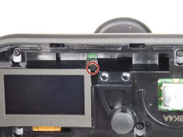

    • Remove the five 6mm screws using the Phillips #0 driver head.
    • There is one screw hidden on the upper right-hand side of the display.

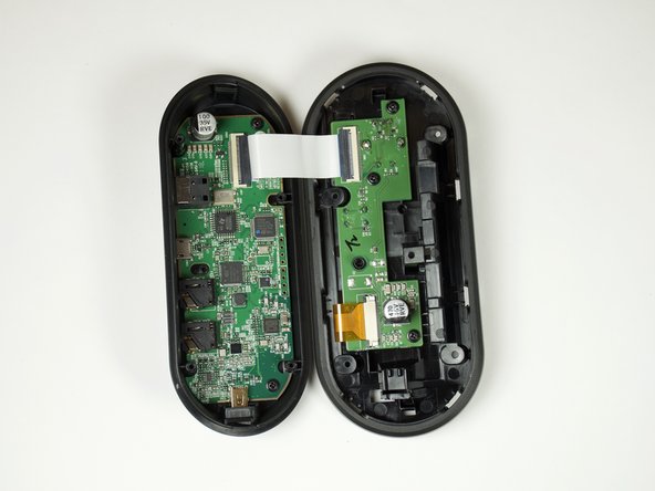

  4. SteelSeries Arctis Pro Plus GameDAC Secondary Button Replacement: crwdns2935265:04crwdnd2935265:01crwdnd2935265:02crwdne2935265:0 SteelSeries Arctis Pro Plus GameDAC Secondary Button Replacement: crwdns2935265:04crwdnd2935265:02crwdnd2935265:02crwdne2935265:0
    • Hold the sides of the GameDAC and pull apart.
    • Don't pull the two sides apart quickly or forcefully to avoid tearing the wire connection between the two boards.
  5. SteelSeries Arctis Pro Plus GameDAC Secondary Button Replacement: crwdns2935265:05crwdnd2935265:01crwdnd2935265:01crwdne2935265:0
    • Remove the three 4mm screws from the circuit board using the Phillips #0 driver head.

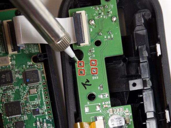

  6. SteelSeries Arctis Pro Plus GameDAC Secondary Button Replacement: crwdns2935265:06crwdnd2935265:01crwdnd2935265:02crwdne2935265:0 SteelSeries Arctis Pro Plus GameDAC Secondary Button Replacement: crwdns2935265:06crwdnd2935265:02crwdnd2935265:02crwdne2935265:0
    • Desolder the four button pins from the board to remove the button.
    • For help desoldering connections, follow this useful guide on How To Solder and Desolder Connections.
    • Use caution when soldering. The heated tip may cause damage to the board or burn you.
