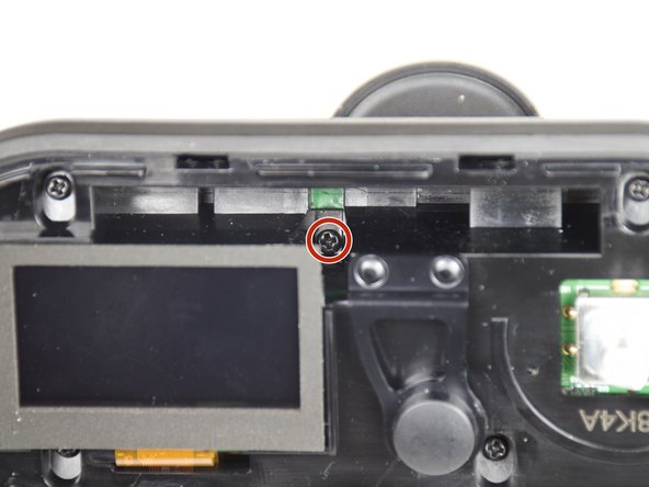

    • Remove the five 6mm screws using the Phillips #0 driver head.
    • There is one screw hidden on the upper right-hand side of the display.

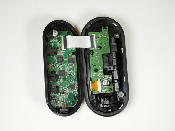

    • Hold the sides of the GameDAC and pull apart.
    • Don't pull the two sides apart quickly or forcefully to avoid tearing the wire connection between the two boards.

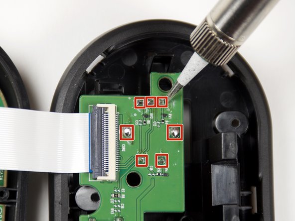

    • Desolder the seven potentiometer pins from the board to remove the button.
    • For help desoldering connections, follow this useful guide on How To Solder and Desolder Connections.
    • Use caution when soldering. The heated tip may cause damage to the board or burn you.
