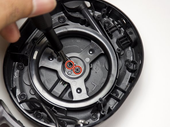

  8. SteelSeries Arctis Pro Plus GameDAC Microphone Cable Replacement: crwdns2935265:08crwdnd2935265:01crwdnd2935265:02crwdne2935265:0 SteelSeries Arctis Pro Plus GameDAC Microphone Cable Replacement: crwdns2935265:08crwdnd2935265:02crwdnd2935265:02crwdne2935265:0
    • Lift up the wire on the rotating wheel with tweezers to move it out of the way of the screws.
    • Remove the two 5mm screws with a Phillips #0 driver head.

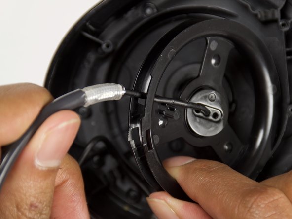

  9. SteelSeries Arctis Pro Plus GameDAC Microphone Cable Replacement: crwdns2935265:09crwdnd2935265:01crwdnd2935265:02crwdne2935265:0 SteelSeries Arctis Pro Plus GameDAC Microphone Cable Replacement: crwdns2935265:09crwdnd2935265:02crwdnd2935265:02crwdne2935265:0
    • Pull out the rotating wheel from the headset casing.
    • Remove the microphone from the casing with the rotator wheel.
    • After removing the rotating wheel, lift the wheel up and use your other hand to feed the microphone through the case.

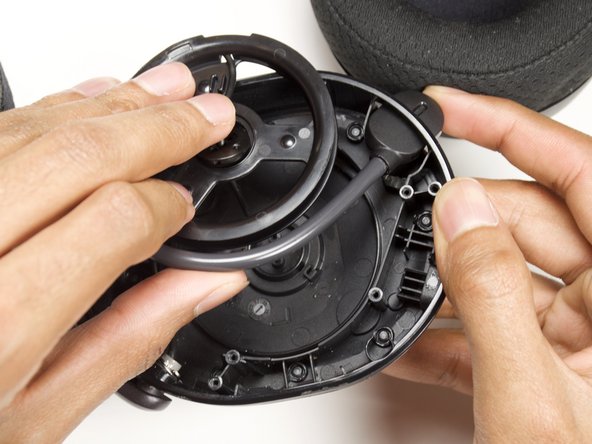

  10. SteelSeries Arctis Pro Plus GameDAC Microphone Cable Replacement: crwdns2935265:010crwdnd2935265:01crwdnd2935265:02crwdne2935265:0 SteelSeries Arctis Pro Plus GameDAC Microphone Cable Replacement: crwdns2935265:010crwdnd2935265:02crwdnd2935265:02crwdne2935265:0
    • Pull the microphone wire out of the wheel.
    • Forcefully removing the microphone from the wheel may break the plastic wheel.
    • Pull the wire and wheel apart to remove the entire component.
