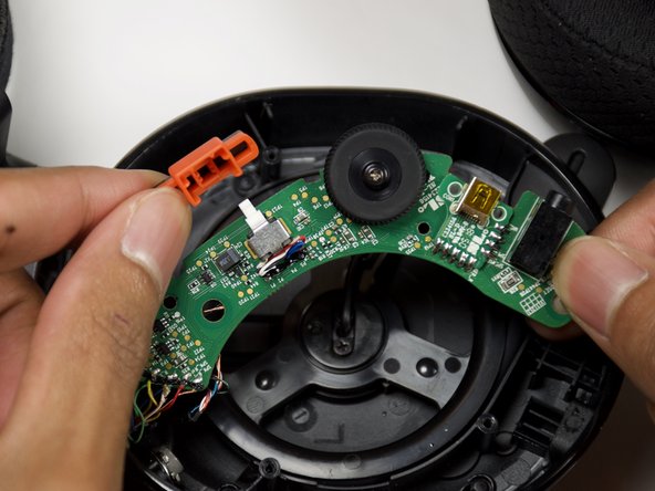

  5. SteelSeries Arctis Pro Plus GameDAC Headset Mute Button Replacement: crwdns2935265:05crwdnd2935265:01crwdnd2935265:01crwdne2935265:0
    • Lift the circuit board out of the plastic housing.
    • Press in on the volume wheel while pulling on the circuit board to help maneuver the circuit board out of the housing.

    • Flip the circuit board over and remove the keycap by pulling on it.

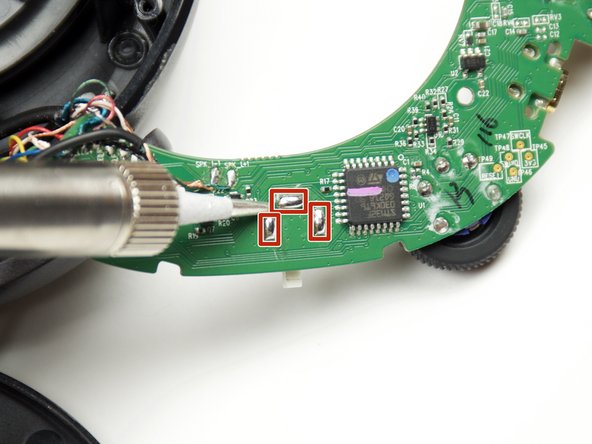

  7. SteelSeries Arctis Pro Plus GameDAC Headset Mute Button Replacement, Headset Mute Button: crwdns2935265:07crwdnd2935265:01crwdnd2935265:01crwdne2935265:0
    • Desolder the wires connecting the button to the circuit board.
    • For help desoldering connections, follow this useful guide on How To Solder and Desolder Connections.
    • Use caution when soldering. The heated tip may cause damage to the board or burn you.
  8. SteelSeries Arctis Pro Plus GameDAC Headset Mute Button Replacement: crwdns2935265:08crwdnd2935265:01crwdnd2935265:02crwdne2935265:0 SteelSeries Arctis Pro Plus GameDAC Headset Mute Button Replacement: crwdns2935265:08crwdnd2935265:02crwdnd2935265:02crwdne2935265:0
    • Desolder the three pins to remove the button from the circuit board.
