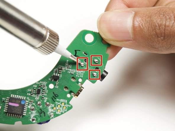

  6. SteelSeries Arctis Pro Plus GameDAC 3.5mm Headphone Jack Replacement: crwdns2935265:06crwdnd2935265:01crwdnd2935265:02crwdne2935265:0 SteelSeries Arctis Pro Plus GameDAC 3.5mm Headphone Jack Replacement: crwdns2935265:06crwdnd2935265:02crwdnd2935265:02crwdne2935265:0
    • Desolder the three connecting audio jack leads from the circuit board.
    • For help desoldering connections, follow this useful guide on How To Solder and Desolder Connections.
    • Use caution when soldering. The heated tip may cause damage to the board or burn you.
