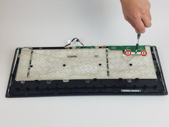

    1. SteelSeries Apex 64145 LED Replacement, LED: crwdns2935265:05crwdnd2935265:01crwdnd2935265:02crwdne2935265:0 SteelSeries Apex 64145 LED Replacement, LED: crwdns2935265:05crwdnd2935265:02crwdnd2935265:02crwdne2935265:0
      • Unscrew the two silver 4.0 mm Phillips #1 screws and the three black 6.5 mm Phillips #1 screws holding the silicone sheets.
    2. SteelSeries Apex 64145 LED Replacement: crwdns2935265:06crwdnd2935265:01crwdnd2935265:01crwdne2935265:0
      • Flip the chip slightly in order to remove the sheets.
    3. SteelSeries Apex 64145 LED Replacement: crwdns2935265:07crwdnd2935265:01crwdnd2935265:01crwdne2935265:0
      • Remove the sheets.

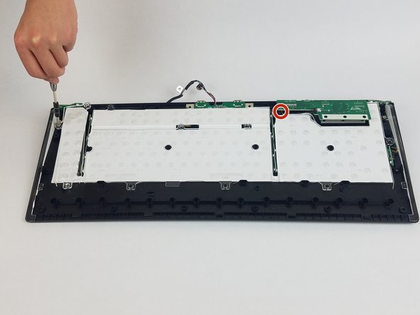

    4. SteelSeries Apex 64145 LED Replacement: crwdns2935265:08crwdnd2935265:01crwdnd2935265:02crwdne2935265:0 SteelSeries Apex 64145 LED Replacement: crwdns2935265:08crwdnd2935265:02crwdnd2935265:02crwdne2935265:0
      • Unscrew the two silver 4.5 mm Phillips #1 screws and the seven 5.0 mm Phillips #1 screws that deter the plastic panel from removal.
    5. SteelSeries Apex 64145 LED Replacement: crwdns2935265:09crwdnd2935265:01crwdnd2935265:01crwdne2935265:0
      • Remove the plastic panel and the white sheet.

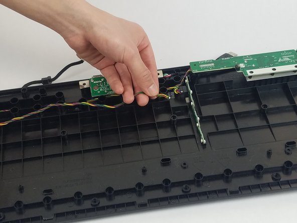

    6. SteelSeries Apex 64145 LED Replacement: crwdns2935265:010crwdnd2935265:01crwdnd2935265:03crwdne2935265:0 SteelSeries Apex 64145 LED Replacement: crwdns2935265:010crwdnd2935265:02crwdnd2935265:03crwdne2935265:0 SteelSeries Apex 64145 LED Replacement: crwdns2935265:010crwdnd2935265:03crwdnd2935265:03crwdne2935265:0
      • Unplug the wires connected to the LEDs.
    7. SteelSeries Apex 64145 LED Replacement: crwdns2935265:011crwdnd2935265:01crwdnd2935265:02crwdne2935265:0 SteelSeries Apex 64145 LED Replacement: crwdns2935265:011crwdnd2935265:02crwdnd2935265:02crwdne2935265:0
      • Remove the LEDs.
