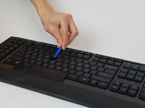

    • Insert the plastic opening tool underneath the edge of the key.
  3. SteelSeries Apex 64145 Key Replacement: crwdns2935265:03crwdnd2935265:01crwdnd2935265:02crwdne2935265:0 SteelSeries Apex 64145 Key Replacement: crwdns2935265:03crwdnd2935265:02crwdnd2935265:02crwdne2935265:0
    • Gently pry the damaged key with the plastic opening tool at an upward angle.
  4. SteelSeries Apex 64145 Key Replacement: crwdns2935265:04crwdnd2935265:01crwdnd2935265:01crwdne2935265:0
    • If replacing, prepare your new key for insertion.
    • If key is dirty, wash the key with room temperature water and dry off the key with a towel.
  5. SteelSeries Apex 64145 Key Replacement: crwdns2935265:05crwdnd2935265:01crwdnd2935265:01crwdne2935265:0
    • Gently push the key back into the slot until you hear a click.
