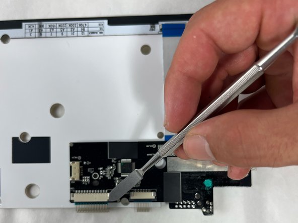

    • Use a JIS #00 screwdriver to remove all back panel screws.
  2. SteelSeries Apex 3 TKL LED Panel Replacement: crwdns2935265:02crwdnd2935265:01crwdnd2935265:02crwdne2935265:0 SteelSeries Apex 3 TKL LED Panel Replacement: crwdns2935265:02crwdnd2935265:02crwdnd2935265:02crwdne2935265:0
    • Use the iFixit opening pick to pry open the back panel by running it along the edges of the keyboard.
  3. SteelSeries Apex 3 TKL LED Panel Replacement, LED Panel: crwdns2935265:03crwdnd2935265:01crwdnd2935265:02crwdne2935265:0 SteelSeries Apex 3 TKL LED Panel Replacement, LED Panel: crwdns2935265:03crwdnd2935265:02crwdnd2935265:02crwdne2935265:0
    • Release the ribbon wire connections using the metal spudger which has a more rigid tip for undoing the clips.
  4. SteelSeries Apex 3 TKL LED Panel Replacement: crwdns2935265:04crwdnd2935265:01crwdnd2935265:01crwdne2935265:0
    • Separate the LED panel from the keyboard casing.
