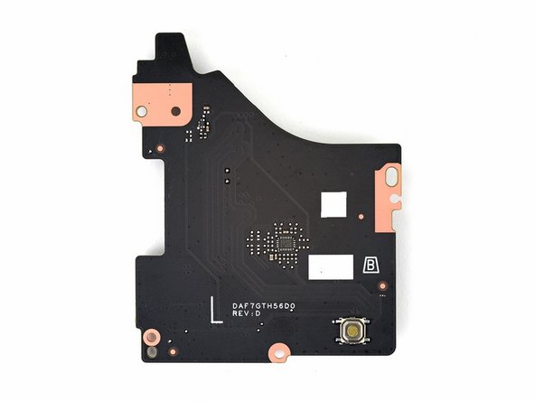

This guide contains a selection of photos and chip identification summary for Valve's Steam Deck OLED.
Special thanks to community member CChin for his contribution!
crwdns2935311:0crwdnd2935311:0crwdne2935311:0 crwdns2935313:0Steam Deck OLEDcrwdnd2935313:0crwdnd2935313:0crwdne2935313:0
    1. Steam Deck OLED Chip ID, Main Board Side 1: crwdns2935265:01crwdnd2935265:01crwdnd2935265:02crwdne2935265:0 Steam Deck OLED Chip ID, Main Board Side 1: crwdns2935265:01crwdnd2935265:02crwdnd2935265:02crwdne2935265:0
      • AMD/Valve 100-000000932 application processor
      • Micron MT62F1G64D4AH-023 WT:B 8 GB LPDDR5 SDRAM memory
      • Winbond W25Q128JW 16 MB serial NOR flash memory
      • Monolithic Power Systems MP2762A 2 cell battery charger
      • Analog Devices MAX98389 class-D audio amplifier
      • Monolithic Power Systems MP8892 power management
      • Monolithic Power Systems MP2845 multiphase controller
    2. Steam Deck OLED Chip ID: crwdns2935265:02crwdnd2935265:01crwdnd2935265:01crwdne2935265:0
      • Likely Monolithic Power Systems MP86902-B DC-DC converter
      • Diodes Incorporated PI3USB102 dual SPDT analog switch
      • Texas Instruments TPD6S300A USB Type-C port protector
    3. Steam Deck OLED Chip ID, Main Board Side 2: crwdns2935265:03crwdnd2935265:01crwdnd2935265:02crwdne2935265:0 Steam Deck OLED Chip ID, Main Board Side 2: crwdns2935265:03crwdnd2935265:02crwdnd2935265:02crwdne2935265:0
      • Likely ITE Tech IT81302VG embeddded controller
      • Silicon Mitus SM3010A power management
      • Nuvoton NAU88L21YG audio codec
      • O2Micro OZ711 card reader controller
      • Analogix ANX7580 DisplayPort to single MIPI receiver converter
    4. Steam Deck OLED Chip ID, Left Controller Board Sides 1 & 2: crwdns2935265:04crwdnd2935265:01crwdnd2935265:02crwdne2935265:0 Steam Deck OLED Chip ID, Left Controller Board Sides 1 & 2: crwdns2935265:04crwdnd2935265:02crwdnd2935265:02crwdne2935265:0
      • Likely Allegro MicroSystems Hall Sensor
    5. Steam Deck OLED Chip ID, Right Controller Board Sides 1 & 2: crwdns2935265:05crwdnd2935265:01crwdnd2935265:02crwdne2935265:0 Steam Deck OLED Chip ID, Right Controller Board Sides 1 & 2: crwdns2935265:05crwdnd2935265:02crwdnd2935265:02crwdne2935265:0
      • Renesas R7FA4E10B2CFM 32-bit ARM Cortex-M33 Microcontroller
      • Bosch Sensortec BHI160B 6-axis accelerometer and gyroscope
