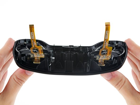

    • It's a trap! Lifting the motherboard out of its housing reveals a couple hidden ribbon cables connecting the touchpads to the underside of the board.
    • Repairer beware: removing the motherboard without dispatching these cables will greatly increase your repair woes.
    • We're never fans of treacherous cables like these, but this is hardly the worst we've seen.
    • Moving right along, we disconnect the ribbon cables with a firm tug, freeing the upper assembly for closer inspection and giving us a glimpse at the inner workings of the touchpads.

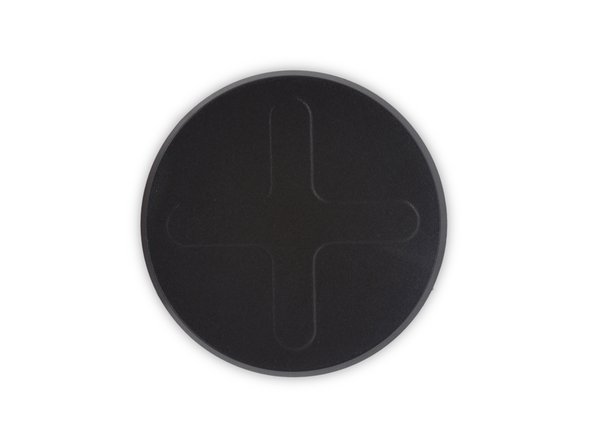

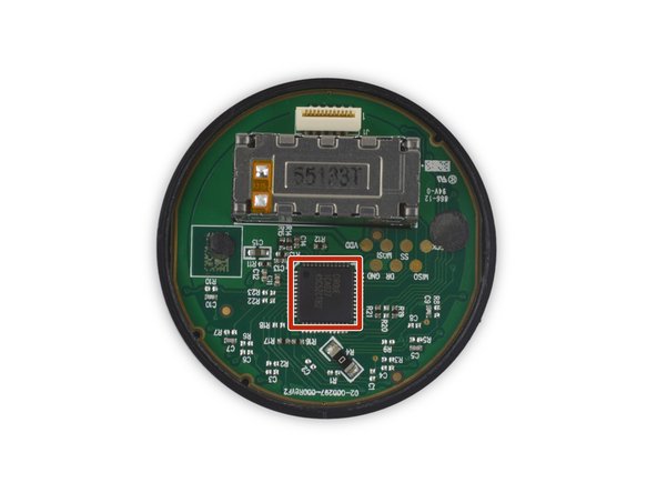

    • We finally break out our favorite tools to bust the touchpad out from behind its bracket bars. This time, we're using a plastic opening tool from our all-new Pro Tech Toolkit.
    • The ribbon cable plugs into a socket on the touchpad daughterboard and is soldered to the haptic feedback actuators, adding some redundancy and durability to the touchpad module.
    • The whole assembly is a touchpad solution from Cirque, likely the GlidePoint TM040040.
    • The brains of the operation is a Cirque 1CA027 companion MCU.
    • Also hiding on the daughterboard we find one of our least favorite things: glue. Those two black globs are mounds of adhesive, securing the touchpad to its bracket.
    • Happily, this is the only adhesive we encountered in this device, and neutralizing it didn't get too messy.
