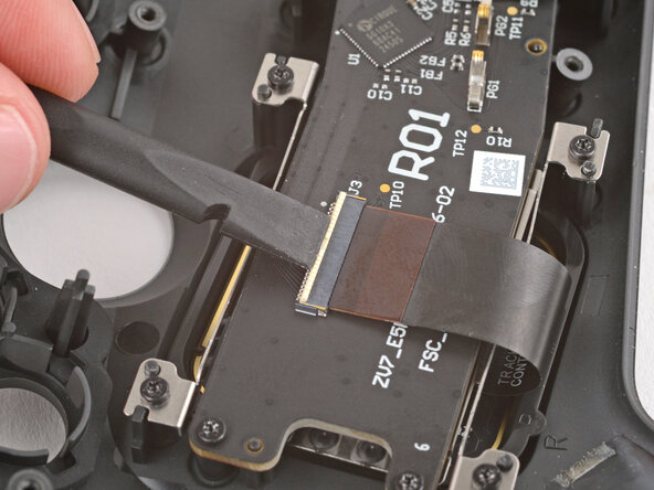

    4. Steam Controller (2nd Gen, 2026) Buttons Replacement, Disconnect the touchpad cables: crwdns2935265:023crwdnd2935265:01crwdnd2935265:03crwdne2935265:0 Steam Controller (2nd Gen, 2026) Buttons Replacement, Disconnect the touchpad cables: crwdns2935265:023crwdnd2935265:02crwdnd2935265:03crwdne2935265:0 Steam Controller (2nd Gen, 2026) Buttons Replacement, Disconnect the touchpad cables: crwdns2935265:023crwdnd2935265:03crwdnd2935265:03crwdne2935265:0
      • Use the flat end of a spudger to lift the hinged, locking flap on one of the touchpad ZIF connectors.
    5. Steam Controller (2nd Gen, 2026) Buttons Replacement: crwdns2935265:024crwdnd2935265:01crwdnd2935265:02crwdne2935265:0 Steam Controller (2nd Gen, 2026) Buttons Replacement: crwdns2935265:024crwdnd2935265:02crwdnd2935265:02crwdne2935265:0
      • Use tweezers to grip the cable by its plastic pull tab and slide it out of the socket.
    6. Steam Controller (2nd Gen, 2026) Buttons Replacement: crwdns2935265:025crwdnd2935265:01crwdnd2935265:03crwdne2935265:0 Steam Controller (2nd Gen, 2026) Buttons Replacement: crwdns2935265:025crwdnd2935265:02crwdnd2935265:03crwdne2935265:0 Steam Controller (2nd Gen, 2026) Buttons Replacement: crwdns2935265:025crwdnd2935265:03crwdnd2935265:03crwdne2935265:0
      • Repeat to disconnect the other touchpad cable.

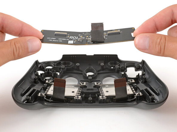

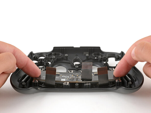

    7. Steam Controller (2nd Gen, 2026) Buttons Replacement, Remove the FSC board screws: crwdns2935265:026crwdnd2935265:01crwdnd2935265:02crwdne2935265:0 Steam Controller (2nd Gen, 2026) Buttons Replacement, Remove the FSC board screws: crwdns2935265:026crwdnd2935265:02crwdnd2935265:02crwdne2935265:0
      • Use a T5 Torx screwdriver to remove the four 6.0 mm‑long screws securing the FSC board.
    8. Steam Controller (2nd Gen, 2026) Buttons Replacement, Remove the FSC board: crwdns2935265:027crwdnd2935265:01crwdnd2935265:03crwdne2935265:0 Steam Controller (2nd Gen, 2026) Buttons Replacement, Remove the FSC board: crwdns2935265:027crwdnd2935265:02crwdnd2935265:03crwdne2935265:0 Steam Controller (2nd Gen, 2026) Buttons Replacement, Remove the FSC board: crwdns2935265:027crwdnd2935265:03crwdnd2935265:03crwdne2935265:0
      • Remove the FSC board.
      • During reassembly:
      • Use the alignment pegs to ensure the board is correctly positioned.
