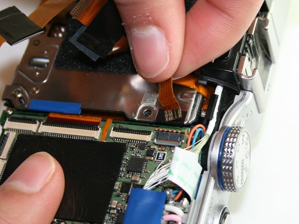

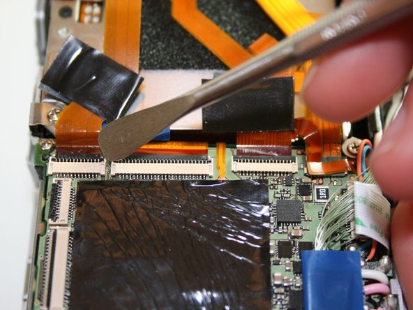

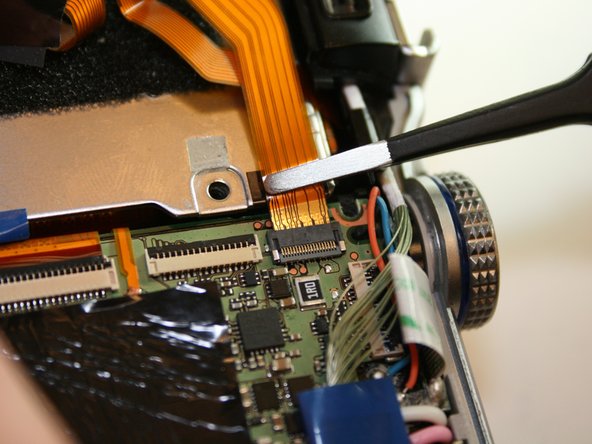

      • Disconnect the two ribbon cables as shown in picture one.
      • Avoid using metal pry tools, as shown in the photo, on internal electronic components, as it can cause a short and damage the device. Use an ESD-safe tool such as a standard nylon spudger.
      • To disconnect a ribbon cable, use a spudger to lift the black tab then pull the ribbon out. This works the same for all ribbon cables.

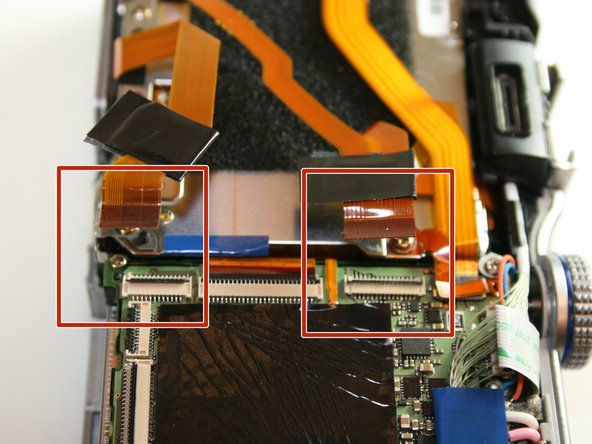

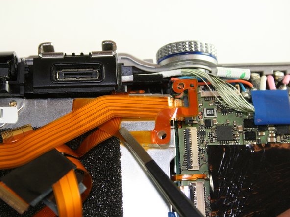

      • Using a spudger, remove the ribbon cables by pushing the black tab back and gently pulling the cable out.
      • Do this process for the two ribbon cables shown in the third photo.

      • Unlike previous connectors, this cable has a light grey clip holding it in place on opposite side of the connector in regards where the ribbon is inserted. Flip it up and then using your fingers, gently pull the top ribbon cable out.

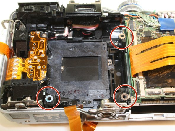

      • Remove the bracket in the lower right hand corner. In order to do so, you must remove two different screws.
      • Using the #000 Phillips screwdriver, remove the 2.4 mm screw on the bottom.
      • Using the #000 Phillips screwdriver, remove the 6.0 mm screw on the top and lift off the bracket.

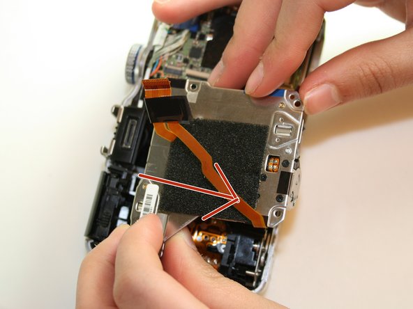

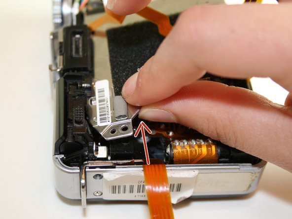

      • Now you can lift out the sensor assembly. The following steps will explain how to lift it out.
      • First, sightly lift the bottom half following the direction of the arrow.
      • Second, lift the top left up side up. It may be a little stuck so you will have to wiggle it out.
      • Finally, pull the entire assembly towards the bottom and away from the case.
      • There is a ribbon connector that is beneath the assembly. Be careful when lifting the assembly out. Do not yank it out very hard or you may damage the ribbon connector.

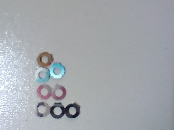

      • There are three washers held in by the 6.0 mm screws as shown in picture two. Be sure to replace them when reassembling.
