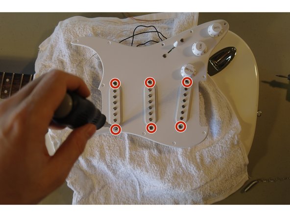

  2. Squier Strat Guitar Pickups Replacement: crwdns2935265:02crwdnd2935265:01crwdnd2935265:02crwdne2935265:0 Squier Strat Guitar Pickups Replacement: crwdns2935265:02crwdnd2935265:02crwdnd2935265:02crwdne2935265:0
    • Remove the 11 screws holding the pickguard to the body of the guitar.

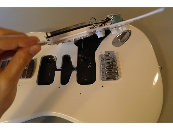

  3. Squier Strat Guitar Pickups Replacement: crwdns2935265:03crwdnd2935265:01crwdnd2935265:03crwdne2935265:0 Squier Strat Guitar Pickups Replacement: crwdns2935265:03crwdnd2935265:02crwdnd2935265:03crwdne2935265:0 Squier Strat Guitar Pickups Replacement: crwdns2935265:03crwdnd2935265:03crwdnd2935265:03crwdne2935265:0
    • Lift up the pickup guard gently.
    • Flip the pickup guard to expose the wiring.
    • Place a towel underneath the pickup guard to protect your guitar's body.
    • Potential for device damage: Do not use excessive force when lifting the pickup guard.

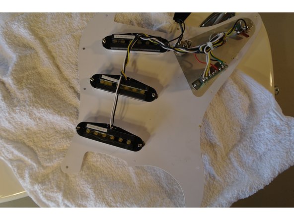

    • Flip the pickup guard back to its original position.
    • Remove the screws holding the pickups to the pickup guard.
  7. Squier Strat Guitar Pickups Replacement: crwdns2935265:07crwdnd2935265:01crwdnd2935265:02crwdne2935265:0 Squier Strat Guitar Pickups Replacement: crwdns2935265:07crwdnd2935265:02crwdnd2935265:02crwdne2935265:0
    • Flip the pickup guard to reveal the wiring.
    • Remove the pickups from the pickup guard. They should come out very easily.
