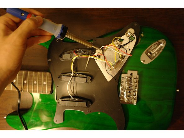

  5. Squier Strat Guitar Pickups Replacement: crwdns2935265:05crwdnd2935265:01crwdnd2935265:02crwdne2935265:0 Squier Strat Guitar Pickups Replacement: crwdns2935265:05crwdnd2935265:02crwdnd2935265:02crwdne2935265:0
    Desoldering Pump
    $3.99
    • Using the the soldering iron and the solder sucker (or the soldering wick), take away any soldering connections of the potentiometers and the five-way switch.
