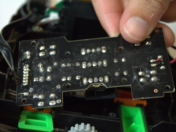

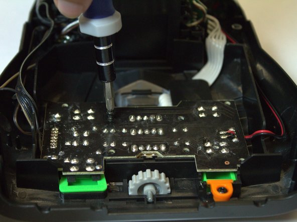

    • Remove the eight black 7.2 mm Phillips #0 screws from the top of the circuit board and remove the circuit board.

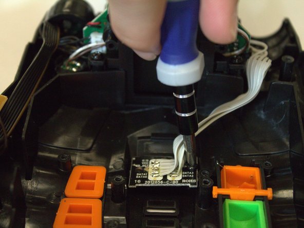

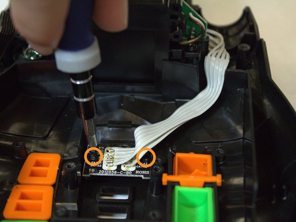

    • Unscrew the one 7.2 mm Phillips #0 screw from the plastic piece covering the microSD reader.
    • Then, unscrew the two 7.2 mm Phillips #0 screws from the microSD reader and remove it from its fastening.
  5. Spy Net Ultra Vision Goggles MicroSD Card Reader Replacement, Un-Soldering the Wires: crwdns2935265:05crwdnd2935265:01crwdnd2935265:01crwdne2935265:0
    • On the back side of the reader there are nine wires. Un-solder these wires, remove the micro SD card reader, and solder on the replacement.
