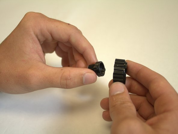

    • Remove the six silver 11.4 mm Phillips #0 screws and pry open the device, using the plastic opening tools if necessary. To do this, locate the groves running along the side of the entire device and wedge it open.
  2. Spy Net Ultra Vision Goggles Lens Replacement, Remove the Lens Housing: crwdns2935265:02crwdnd2935265:01crwdnd2935265:02crwdne2935265:0 Spy Net Ultra Vision Goggles Lens Replacement, Remove the Lens Housing: crwdns2935265:02crwdnd2935265:02crwdnd2935265:02crwdne2935265:0
    • Once the device is open, remove the lens tunnel, then twist the lens to unscrew it from the camera.
  3. Spy Net Ultra Vision Goggles Lens Replacement: crwdns2935265:03crwdnd2935265:01crwdnd2935265:02crwdne2935265:0 Spy Net Ultra Vision Goggles Lens Replacement: crwdns2935265:03crwdnd2935265:02crwdnd2935265:02crwdne2935265:0
    • Remove the two black 7.15 mm Phillips #00 screws from the lens.
    • Once the screws are out, the lens casing should pull apart.
