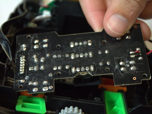

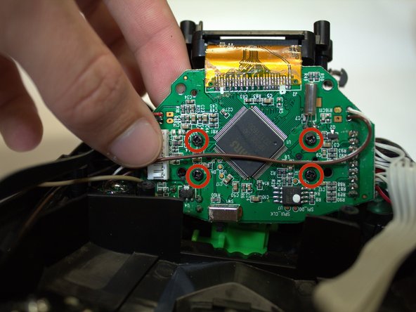

  3. Spy Net Ultra Vision Goggles Camera & Display Screen Assembly Replacement, Remove the Circuit Board: crwdns2935265:03crwdnd2935265:01crwdnd2935265:02crwdne2935265:0 Spy Net Ultra Vision Goggles Camera & Display Screen Assembly Replacement, Remove the Circuit Board: crwdns2935265:03crwdnd2935265:02crwdnd2935265:02crwdne2935265:0
    • Remove the eight black 7.2 mm Phillips #0 screws from the top of the circuit board and lift it out of its place.
    • Be careful not to put too much tension on the various wires.

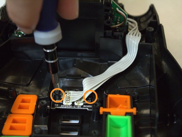

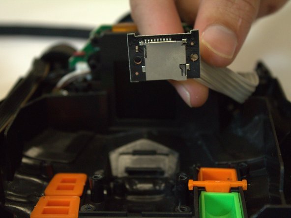

  4. Spy Net Ultra Vision Goggles Camera & Display Screen Assembly Replacement, Remove the MicroSD Card Reader: crwdns2935265:04crwdnd2935265:01crwdnd2935265:03crwdne2935265:0 Spy Net Ultra Vision Goggles Camera & Display Screen Assembly Replacement, Remove the MicroSD Card Reader: crwdns2935265:04crwdnd2935265:02crwdnd2935265:03crwdne2935265:0 Spy Net Ultra Vision Goggles Camera & Display Screen Assembly Replacement, Remove the MicroSD Card Reader: crwdns2935265:04crwdnd2935265:03crwdnd2935265:03crwdne2935265:0
    • Remove the one black 7.2 mm Phillips #0 screw from the plastic piece that holds down the microSD card reader wires.
    • Remove the two black 7.2 mm Phillips #0 screws that hold the microSD card reader in place.
    • You should now be able to lift the microSD card reader out of place.

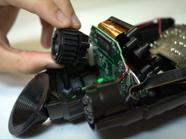

  7. Spy Net Ultra Vision Goggles Camera & Display Screen Assembly Replacement, Remove the Lens & Filter Assembly: crwdns2935265:07crwdnd2935265:01crwdnd2935265:03crwdne2935265:0 Spy Net Ultra Vision Goggles Camera & Display Screen Assembly Replacement, Remove the Lens & Filter Assembly: crwdns2935265:07crwdnd2935265:02crwdnd2935265:03crwdne2935265:0 Spy Net Ultra Vision Goggles Camera & Display Screen Assembly Replacement, Remove the Lens & Filter Assembly: crwdns2935265:07crwdnd2935265:03crwdnd2935265:03crwdne2935265:0
    • Turn the device around to the other side and lift up the screen assembly.
    • Remove the four black 7.2 mm Phillips #00 screws that hold the lens & filter assembly in place.
    • Pull the lens & filter assembly away from the circuit board.

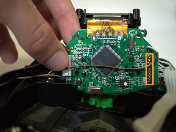

  8. Spy Net Ultra Vision Goggles Camera & Display Screen Assembly Replacement, Detach the Wires: crwdns2935265:08crwdnd2935265:01crwdnd2935265:02crwdne2935265:0 Spy Net Ultra Vision Goggles Camera & Display Screen Assembly Replacement, Detach the Wires: crwdns2935265:08crwdnd2935265:02crwdnd2935265:02crwdne2935265:0
    • Using the soldering iron, de-solder the various wires from the front and back of the circuit board.
    • There are three pairs of wires on the front side, along with a set of 7 leads for the main circuit board connector.
    • On the back side, there is a set of 9 leads for the microSD card connector.
