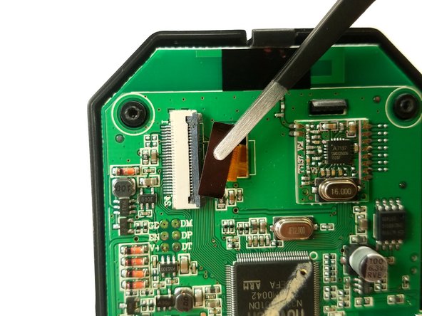

  7. Spy Gear Video Walkie Talkies Camera Replacement: crwdns2935265:07crwdnd2935265:01crwdnd2935265:02crwdne2935265:0 Spy Gear Video Walkie Talkies Camera Replacement: crwdns2935265:07crwdnd2935265:02crwdnd2935265:02crwdne2935265:0
    • Release the zero insertion force (ZIF) connector.
    • Pull the ribbon cable away carefully.
  8. Spy Gear Video Walkie Talkies Camera Replacement: crwdns2935265:08crwdnd2935265:01crwdnd2935265:01crwdne2935265:0
    • With the ribbon cable free from obstructions, use a Prying Tool to release the circuit board from the guide studs.
