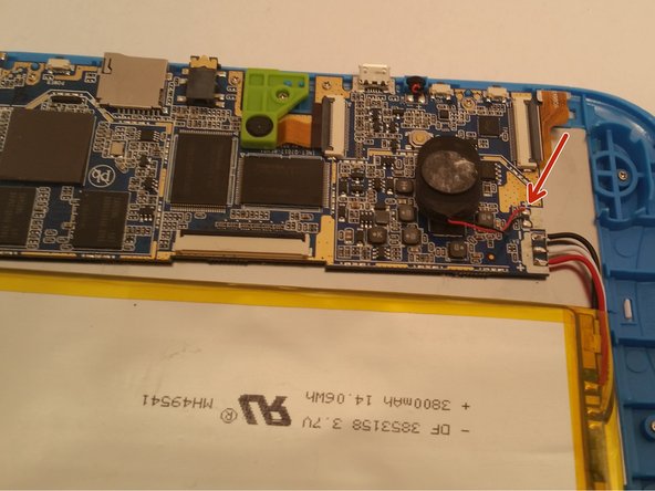

    2. Sprout Channel Cubby Speaker Replacement: crwdns2935265:03crwdnd2935265:01crwdnd2935265:02crwdne2935265:0 Sprout Channel Cubby Speaker Replacement: crwdns2935265:03crwdnd2935265:02crwdnd2935265:02crwdne2935265:0
      • Remove black tape.
      • Disconnect the red and black wires which are soldered to the device. Make sure to not remove the wires that connect to the battery.
      • Replace the speaker.
      • Follow the steps in reverse order (be sure to solder the wires correctly) to install it.
