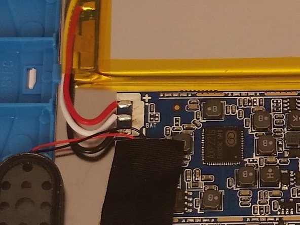

    1. Sprout Channel Cubby Battery Replacement, Battery: crwdns2935265:02crwdnd2935265:01crwdnd2935265:02crwdne2935265:0 Sprout Channel Cubby Battery Replacement, Battery: crwdns2935265:02crwdnd2935265:02crwdnd2935265:02crwdne2935265:0
      • Remove the black electrical tape over the ribbon connector.
      • Remove the ribbon connector over the battery.
      • Make sure to be careful of the ribbon connector while working on the device.
    2. Sprout Channel Cubby Battery Replacement: crwdns2935265:03crwdnd2935265:01crwdnd2935265:01crwdne2935265:0
      • Next you must heat up the battery to help weaken the adhesive connecting the battery to the device.
    3. Sprout Channel Cubby Battery Replacement: crwdns2935265:04crwdnd2935265:01crwdnd2935265:01crwdne2935265:0
      • Once this is done start to pry the battery away from the device carefully. It helps to start at the corners and move inward.
    4. Sprout Channel Cubby Battery Replacement: crwdns2935265:05crwdnd2935265:01crwdnd2935265:02crwdne2935265:0 Sprout Channel Cubby Battery Replacement: crwdns2935265:05crwdnd2935265:02crwdnd2935265:02crwdne2935265:0
      • Once you remove the battery from the device it is still connected by three wires: red, black, and, white. It is important to remember the order they are in when reconnecting the new battery.

Ours is only 6 months old. It only works when it stays plugged in. Battery is bad?
Rachel - crwdns2934203:0crwdne2934203:0 crwdns2950251:0crwdne2950251:0
I had the same problem, only played while plugged in and would not charge.. I found that the battery wires while appearing tight one wire had broken inside the wire insulation at the solder pad on the main board. When I redid the connection it charges, and works well. 8/11/16
