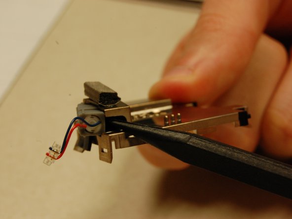

  14. Sprint Sanyo RL-4920 Vibrator Motor Replacement: crwdns2935265:014crwdnd2935265:01crwdnd2935265:03crwdne2935265:0 Sprint Sanyo RL-4920 Vibrator Motor Replacement: crwdns2935265:014crwdnd2935265:02crwdnd2935265:03crwdne2935265:0 Sprint Sanyo RL-4920 Vibrator Motor Replacement: crwdns2935265:014crwdnd2935265:03crwdnd2935265:03crwdne2935265:0
    • Once the metal casing is removed from the circuit board take it and locate the vibrator motor on the top side of the casing
    • Use the spudger tool to gently pry the vibrator motor out of its protective shell
  15. Sprint Sanyo RL-4920 Vibrator Motor Replacement: crwdns2935265:015crwdnd2935265:01crwdnd2935265:01crwdne2935265:0
    • With the vibrator motor completely removed, you can now replace it with a new one
