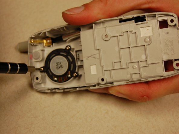

  7. Sprint Sanyo RL-4920 Speaker Replacement, Screws: crwdns2935265:07crwdnd2935265:01crwdnd2935265:02crwdne2935265:0 Sprint Sanyo RL-4920 Speaker Replacement, Screws: crwdns2935265:07crwdnd2935265:02crwdnd2935265:02crwdne2935265:0
    • Locate the three screws securing the speaker.
    • Use a Phillips-head screw bit to unscrew the screws
  8. Sprint Sanyo RL-4920 Speaker Replacement, Replace Speaker: crwdns2935265:08crwdnd2935265:01crwdnd2935265:01crwdne2935265:0
    • Remove the speaker.
    • Replace with new speaker.
    • Secure new speaker with screws and reassemble phone.
