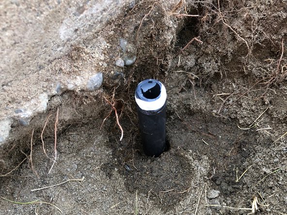

    • Dig a hole down to the base of the sprinkler head.
    • Be careful to avoid puncturing the sprinkler line.
  4. Sprinkler Head Replacement: crwdns2935265:04crwdnd2935265:01crwdnd2935265:01crwdne2935265:0
    • Using your hand or a gardening trowel, finish digging so that the sprinkler head is fully visible and is clear of dirt and debris.

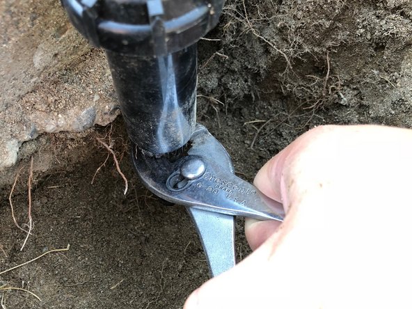

  5. Sprinkler Head Replacement: crwdns2935265:05crwdnd2935265:01crwdnd2935265:02crwdne2935265:0 Sprinkler Head Replacement: crwdns2935265:05crwdnd2935265:02crwdnd2935265:02crwdne2935265:0
    • Unscrew the sprinkler head from the line it is attached to.
    • If is loose enough you may not need pliers.

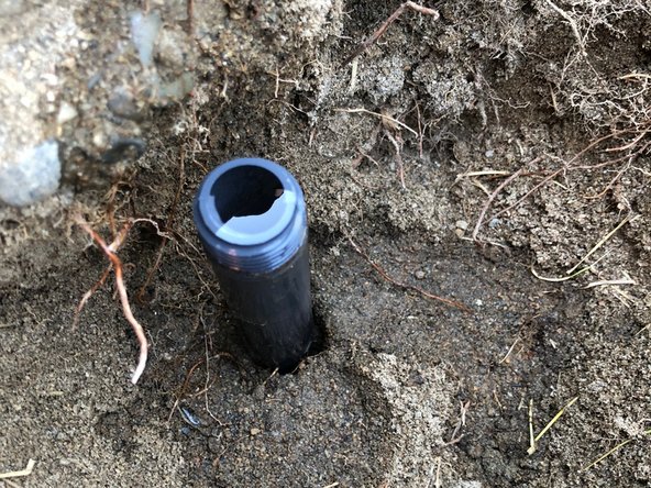

  6. Sprinkler Head Replacement: crwdns2935265:06crwdnd2935265:01crwdnd2935265:02crwdne2935265:0 Sprinkler Head Replacement: crwdns2935265:06crwdnd2935265:02crwdnd2935265:02crwdne2935265:0
    • Coat the threads of the water line with teflon tape to avoid leaking.
