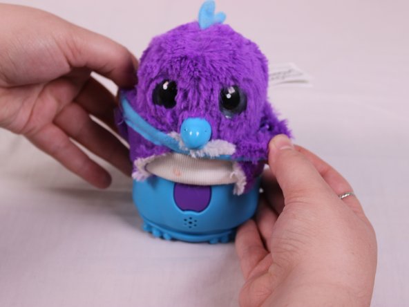

    • lay the Hatchimal on its side.
  2. Spin Master Hatchimal Draggle Wheels Replacement: crwdns2935265:02crwdnd2935265:01crwdnd2935265:01crwdne2935265:0
    • Using the plastic opening tool, push in on the purple clip.

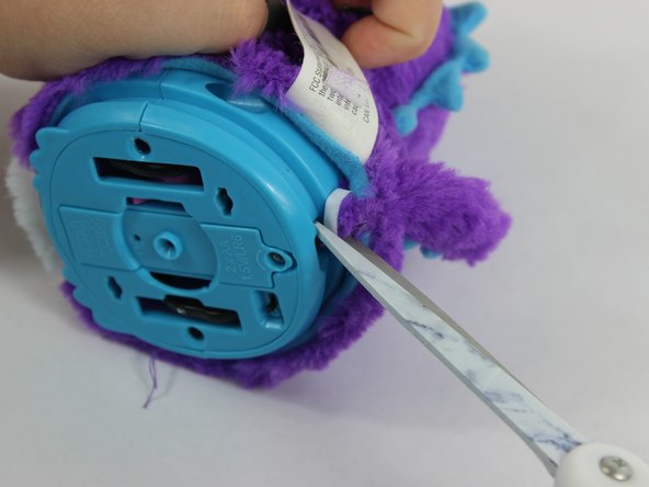

    • Cut the fur retaining zip-tie with a pair of scissors.

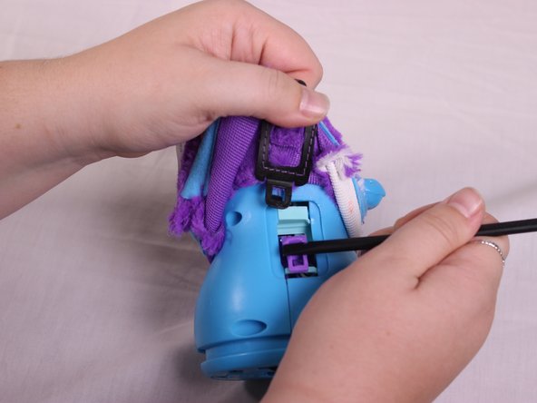

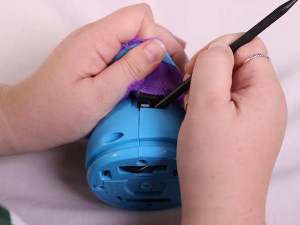

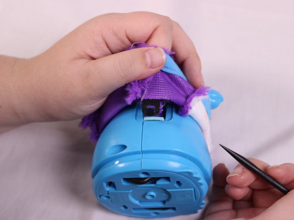

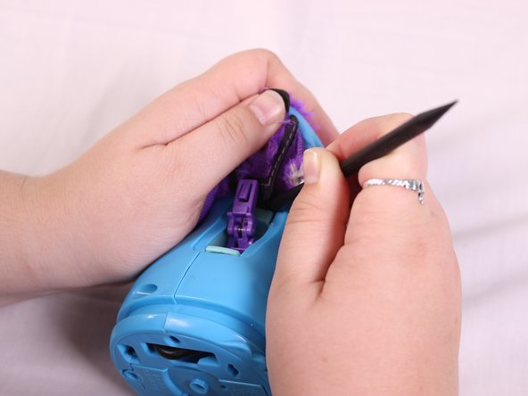

    • Use the spudger tool to push up on the black clip to free it.
    • Pull the clip out.
  7. Spin Master Hatchimal Draggle Wheels Replacement: crwdns2935265:07crwdnd2935265:01crwdnd2935265:03crwdne2935265:0 Spin Master Hatchimal Draggle Wheels Replacement: crwdns2935265:07crwdnd2935265:02crwdnd2935265:03crwdne2935265:0 Spin Master Hatchimal Draggle Wheels Replacement: crwdns2935265:07crwdnd2935265:03crwdnd2935265:03crwdne2935265:0
    • Lift fur up to reveal the next set of clips.
    • Insert a spudger to push up on the black clip to free it.
    • Pull out the clip.

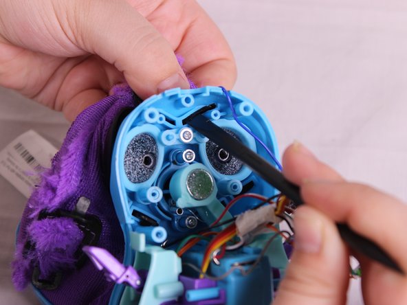

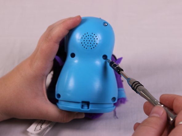

    • Lift the fur up and over the Hatchimals Head.
    • Remove the six 12mm Phillips #00 screws from then body.

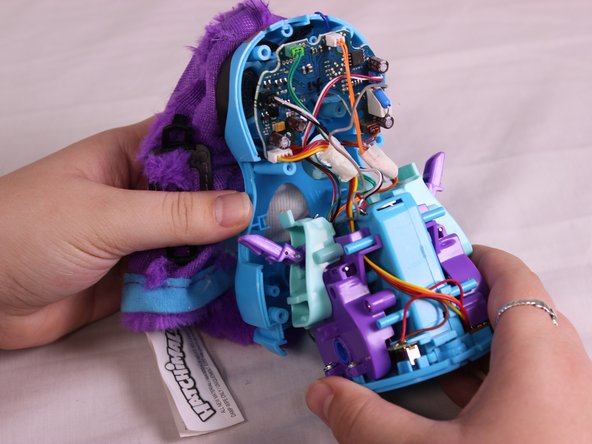

  9. Spin Master Hatchimal Draggle Wheels Replacement: crwdns2935265:09crwdnd2935265:01crwdnd2935265:02crwdne2935265:0 Spin Master Hatchimal Draggle Wheels Replacement: crwdns2935265:09crwdnd2935265:02crwdnd2935265:02crwdne2935265:0

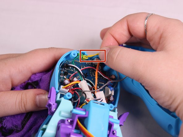

    • Pull the casing apart.
    • Remove the yellow speaker cable.
  10. Spin Master Hatchimal Draggle Wheels Replacement: crwdns2935265:010crwdnd2935265:01crwdnd2935265:03crwdne2935265:0 Spin Master Hatchimal Draggle Wheels Replacement: crwdns2935265:010crwdnd2935265:02crwdnd2935265:03crwdne2935265:0 Spin Master Hatchimal Draggle Wheels Replacement: crwdns2935265:010crwdnd2935265:03crwdnd2935265:03crwdne2935265:0

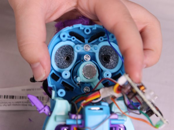

    • Remove the three 7mm Phillips #00 screws from the head.
    • Remove the wheel base and the circuit board carefully not to damage the spring.

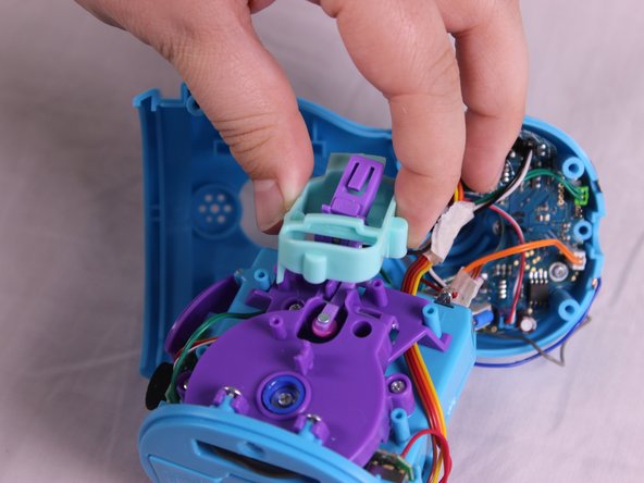

    • Lift up and remove the light blue plastic casing.
  13. Spin Master Hatchimal Draggle Wheels Replacement: crwdns2935265:013crwdnd2935265:01crwdnd2935265:02crwdne2935265:0 Spin Master Hatchimal Draggle Wheels Replacement: crwdns2935265:013crwdnd2935265:02crwdnd2935265:02crwdne2935265:0

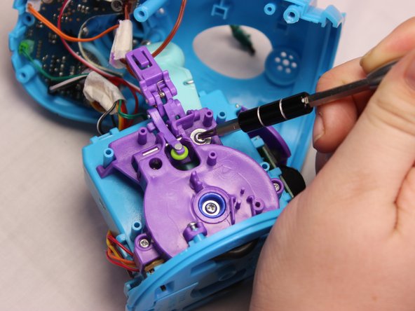

    • Remove the six 7mm Phillips #00 screws.
  14. Spin Master Hatchimal Draggle Wheels Replacement: crwdns2935265:014crwdnd2935265:01crwdnd2935265:02crwdne2935265:0 Spin Master Hatchimal Draggle Wheels Replacement: crwdns2935265:014crwdnd2935265:02crwdnd2935265:02crwdne2935265:0

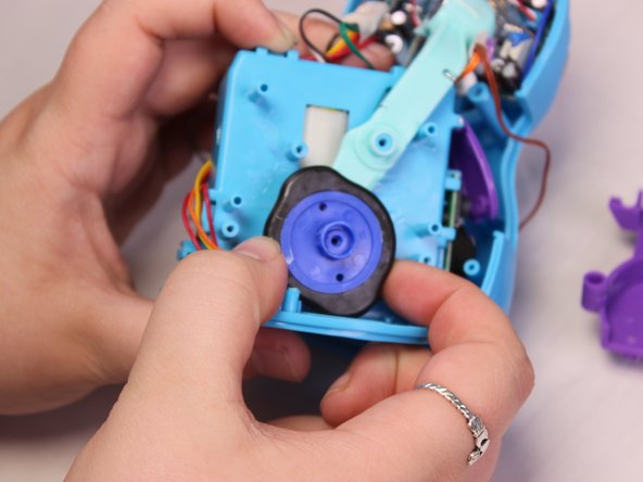

    • Remove the purple plastic casing. It should come off with little resistance.
    • Remove the wheel.
