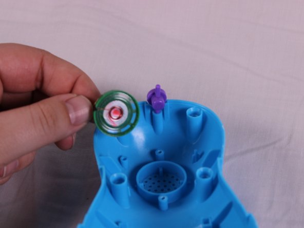

  12. Spin Master Hatchimal Draggle Speaker Replacement, Speaker Replacement: crwdns2935265:012crwdnd2935265:01crwdnd2935265:01crwdne2935265:0
    • Gently pull the yellow speaker cord from circuit board. There will be little resistance.

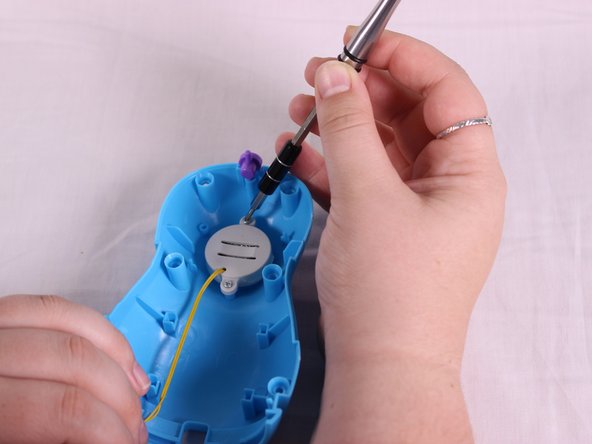

  13. Spin Master Hatchimal Draggle Speaker Replacement: crwdns2935265:013crwdnd2935265:01crwdnd2935265:02crwdne2935265:0 Spin Master Hatchimal Draggle Speaker Replacement: crwdns2935265:013crwdnd2935265:02crwdnd2935265:02crwdne2935265:0
    • Remove the two 7mm Philips #00 screws from the head.
  14. Spin Master Hatchimal Draggle Speaker Replacement: crwdns2935265:014crwdnd2935265:01crwdnd2935265:02crwdne2935265:0 Spin Master Hatchimal Draggle Speaker Replacement: crwdns2935265:014crwdnd2935265:02crwdnd2935265:02crwdne2935265:0
    • Pull the speaker cover off.
    • Remove the speaker.
